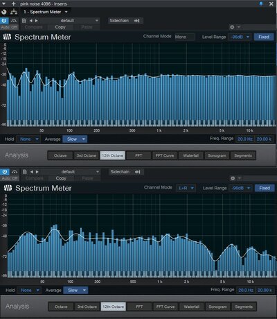

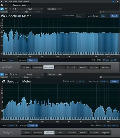

I'm "breaking" Thorn today. This is the best graphic for what i have discovered. Top is 4096 sample pink noise wav file. Bottom is the same file imported into the full 16 slot wavetable of Thorn's oscillator. Frequency response not flat. Thorn colors the sound and quite drastically. I am sure this is for musical usefullness. So check out Throne on a scope. Try the basic waveforms. They don't look anything like what you would expect. To whom It May concern. There IS a method to the madness.

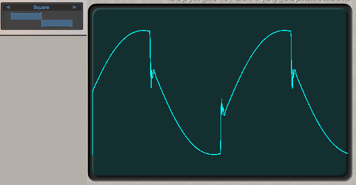

Thorn's internal perfect square :

In my previous post I said there were dips in frequency response in the high end. I BELEIVE I WAS WRONG:

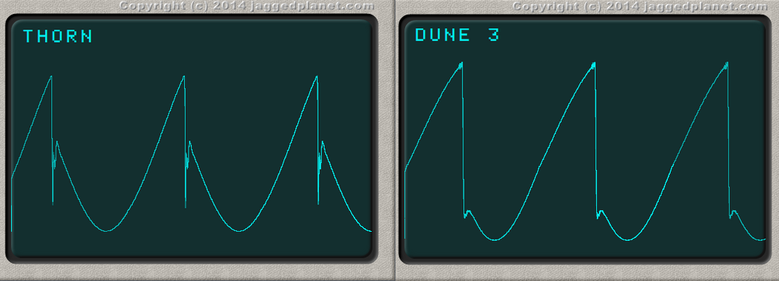

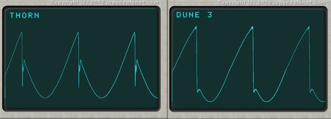

I used the Waldorf wavetable "Wavetrip 1" in Dune 3, and also imported (I had to remove several frames) with the above procedure, into THORN.
I had both wavetables scanning with an LFO. No filter or effects.
I had a spectrum analyzer running on each simultaneously. I tried to make an A/B comparison as much as possible.
In Dune, there was no content below 100 Hz, and no content above 10k, presumably due to the content of the wavetable itself .
In THORN content is possibly being added below 100 and above 10k. Perhaps this is another bug/feature. You can filter off the bottom or top if you don't want it. I guess. I wasn't told this. Maybe it's subharmonic and upper harmonic enhancement?
Thorn on the left, Dune 3 on the right:

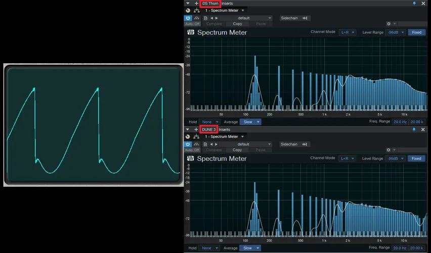

One final test, running a static Waldorf Pulse sawtooth wave in each. The spectrographs actually look almost exactly the same, except for an unexplainable dip at 17.2 kHz on Dune 3 ?? It seems THORN is much more accurate than I thought. Human error must have crept into my previous test somehow.

Oscilloscopes look different, but the sound is the same. I have seen this before with Harmor resynthesis. It can be.
