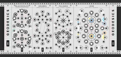

http://www.vstplanet.com/News/2018/pyer-and-marc-boule-releases-geodesics-free-modules-for-vcv-rack-free-synth.htm
Pyer (aka Pierre Collard) and Marc Boule have released Geodesics, a collection of free modules for the free VCV Rack modular synthesizer.
GEODESICS is a free collection of modules for vcv rack available in the plugin manager.
Geodesics includes the following modules:
- Black Holes – Gravitational attenumixet
A black whole attracts everything that gravitates around to its centre, even audio and CV signals… Black Holes is 8 vcas in two groups of 4, it’s also two mixers with 4 channels each.
- Pulsars – Neutron powered crossfader
A pulsar is a star turning on itself and emitting very high and precise frequencies on its spinning axis. Pulsars is a rotating 8 to 1 and 1 to 8 selectors with crossfades in between each signal.
- Branes – Colliding sample and hold
Branes are objects involved into the ekpyrotic theory that describes two parallel universes colliding to create our world… Branes is 2 groups of seven S&H driven by the same trigger source. Triggers can be summed for polyrhythmic effects.
- Ions – Atomic dual sequencer
An Ionic bond describes two atoms that exchanges electrons. Ions is a two voices sequencer. While each voice has its own sequence, they can exchange their steps as easily as an electron can jump from one atom to another.
