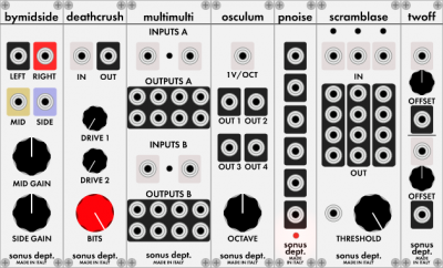

Neue Gratis.Module für VCV.
SonusModular
http://sonusmodular.sonusdept.com/
  • Bymidside: MS (mid-side) encoder
  • Deathcrush: distorsion and bitcrusher
  • Multimulti: a simple but handy double 2-in 8-out multiples
  • Osculum: a VCO capable of harmonic but unusual sounds
  • Piconoise: an ultra compact white noise generator with 8 outputs
  • Scramblase: triple quadruple waveshaper
  • Twoff: double CV static offset
ML_Modules
https://github.com/martin-lueders/ML_modules/releases
  • 8in to 1out summer
Nysthi
https://github.com/antoniotuzzi/nysthi/releases
  • mverb
  • hiverb
  • twistedverb
  • model277
  • logic
