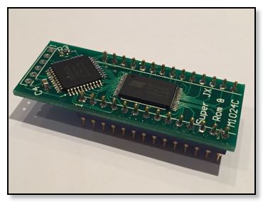

A 16-banks M-1024C cartridge has been developed too, and is available (in limited quantity). See this page. Since cartridges are expensive and hard to find, I designed a new module which replaces the assigner eprom with a flash chip, providing 16 or 32 banks of patches/tones and midi firmware upgrade. See this page for more info.
