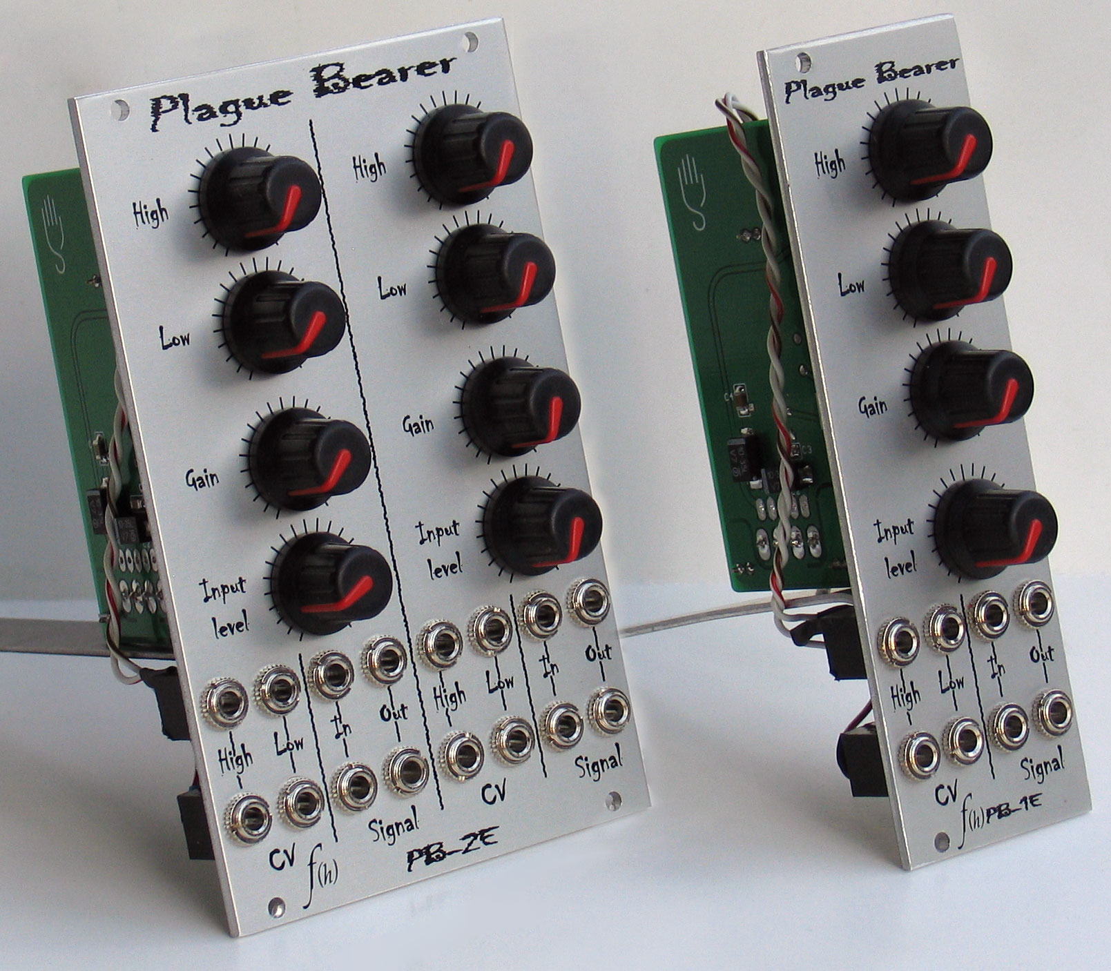

Mal wieder ein kleiner Hersteller: Flight Of Harmony machen einen Eurorack Bandpass-Filter.

Nicht genau, es hat viel Resonanz. Es kann auch selbst-oszillieren. Es kann fast wie einen Kammfilter sich benehmen, und tut viel mehr auch.
Es hat keine CV-Abschwächer, ja. Ich möchte bitte wissen, wieviele Leute hier denken, die in einem Modul wichtig sein würden?

i can't see how to control the resonance and a least one CV attenuator would be important
In my opinion every CV controllable parameter should have an attenuator.
Doepfer is there on the right way.
When i modulate a modul, i use in less then 10% the unattenuated CV input.
OK, i know, to build attenuators in DIY is not a problem, but in this way you need more patchcables and your loosing the overview.

First, I should say that this is not a normal BPF. Es ist sehr anders.
The gain controls the amount of resonance.

This module was designed to be fun, different, and cheap. That is why there are no attenuators. I am working on a "deluxe" version that will have even more control options.

@ gringo: Thanks! Yeah, it is not a clean filter :twisted: It can do a lot of strange things to your signals.
Heh, thanks :) It takes a lot of playing around with to figure it out. All the settings interact. I thought about putting multi-turn or coarse/fine controls on it, and might do that for the big version.
It can do clean/subtle filtering as well, but where is the fun in that?
Sounds cool! I also think attentuators are a must for the big version. In case you build the big version I would buy a unit even for a higher price. If the gain parameter is something like resonance it might also be interesting to "break" up the resonance path to be able to use external sound processing modules like vcas or phasers in it. Doepfers Extreme Filter has this option and i think every filter should have that.
Thank you! I agree about the attenuators. Today, I went to a Synthesizer Meeting and finally had a chance to put the PB in a modular system (I don't have any synths). Now I understand why CV-attenuators are important! I think it needs an additional input attenuator as well - I had to run the source signal into a mixer first to attenuate it enough that the PB would not oscillate :oops:
The "resonance insert" feature looks very interesting, I'll look deeper into that, thanks!
