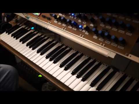

a french guy, Baloran is now making a polyphonic synth..
and it’s output isn’t bad at all:
-8 voice, 2 VCO based on the Moog Source but a lot more advanced – so this is a lot more.
-Ladder VCF
-VCO mod via ENV no problem, PWM, FM …
-discrete LFOs & ENVs (2x) + globaler digital LFO
-8 x multi-timbral
-Arpeggiator & Sequencer/Voice
-5 Oct Fatar TP/8S Keyboard
-Analog TriChorus
-Modulationsmatrix
