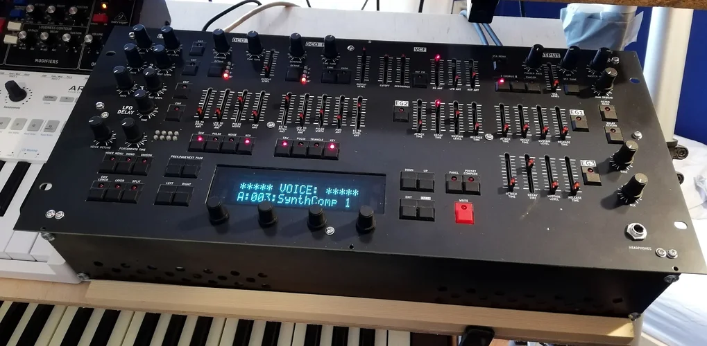

JX-2044 8-Stimmiger Analoger 2-DCO Synth
Lauflicht
TR4ever
Ähnlich Roland JX DCO aber mit mehr Möglichkeiten!
Bi-Timbral!
Kenndaten:
  • 2 DCOs per voice based on JX-8P, but with addition of PWM.
    DCO A features sawtooth, pulse and noise, while DCO B has triangle on the last switch instead. Waveforms can be switched independently and mixed.
  • Cross Mod (AM) - the same circuit as in JX-8P
  • 3 ADSR envelopes per voice, with shape switchable between exponential and linear, RTZ switch and adjustable keytracking (with note number affecting envelope speed relatively to C4 (60).
  • 3 LFOs per voice with seven waveforms - triangle, sine, square, rising ramp, falling ramp, random and noise. LFOs can be switched to mono mode, or work polyphonically with adjustable keyboard tracking, which is very useful e.g. for PWM patches
  • 4 pole resonant low pass filter built around CoolAudio's V2044 chip. Filter can self-oscillate and also has adjustable keyboard tracking.
  • Filter FM using DCO B as a source.
  • 1-pole master HPF per part similar to the one in JX-3P
Initially I tried to use BBD-based chorus, using MN3207 chips, but it was too noisy even for me, so I decided to switch to digital FX.
Each layer has its own FX processor with following blocks:
  • Resonant filterbankwith two modes:
    • VP-330 "Human Voice" section emulation (with two presets)
    • Polymoog resonator emulation
  • Stereo Chorus with three presets - "JX Slow" and "JX Fast" corresponding with "I" and "II" settings from JX-8P, and the third mode is "Stringmachine", which uses three delay lines modulated with dual phase-shifted LFOs.
  • 4 stage phaser
  • Delay / Reverb - switchable between the two. Delay has its own modulation LFO with adjustable rate and amount. Reverb output also can be pitch-modulated.

Vielleicht sollte er versuchen seine Entwicklung an Roland verkaufen? Die Anleitung sollte er dann aber besser selbst schreiben. LOL.
Wenig Echo hier. Wundert mich. So ein Poly hat doch wirklich noch gefehlt. Ich drücke die Daumen, dass das Projekt zur Serienreife kommt.
M.i.a.u.: Teiko, Horn, Moogulator und 3 andere
Na ja ehrlich gesagt, es ist halt "Bastelkram" und Roland baut immer nur für den Massenmarkt(mittlerweile ja auch nur noch ihre ZencoreDSP-Sachen in unterschiedlichen Gehäusedarreichungen). Die Idee wird von Roland nie übernommen werden.
M.i.a.u.: Synthesilent
Würde den Synth in jedem Fall kaufen, wenn die Hardware/Oberfläche auch optisch ansprechend ist.
M.i.a.u.: jack4life
Einen MKS70 wollte ich mir ja immer noch zulegen. Ich warte mal ab, wohin dieses Projekt geht.
M.i.a.u.: Teiko und Horn
Gerade gestern mal nach erschwinglichen Alternativen zu JX-8P geschaut. Der JX-08 scheint ja wohl eher nicht als adäquater Clone durchzugehen.
Vlt. wäre das ja eine gute Alternative ... ?
Bin gespannt was draus wird und auf den Kosta Kwanta.
M.i.a.u.: sllk
Das kommt auf die persönlichen Ansprüche und Geschmack an:
Meinen JX-08 empfand ich als klangliche Verbesserung gegenüber dem Original, weil ich dessen manchmal etwas näselnden Grundsound schon damals nicht mochte - und genau den vermag der JX-08 offenbar nicht mit abzubilden.
Für mich also: besserer Sound, mehr Stimmen, weniger Platzbedarf. Win-win-win!
Aber für die Originalsoundliebhaber, die eine echte analoge Alternative suchen, kommt der 2044 natürlich wie gerufen.
Schöne Grüße und viel Erfolg dem Projekt!
Bert
M.i.a.u.: Teiko
Das Projekt klingt super, und der Prototyp sieht auch ganz einladend aus... Aber falls das ein Keyboard werden sollte, nääh
Bin neugierig wer dieser "respectable synth manufacturer" sein könnte. Üblicherweise werden fremde Ideen nicht ins eigene Portfolio übernommen. Denke damit scheiden die größten und bekanntesten Hersteller schon mal aus... ?!
Vielleicht will der grosse Hersteller mit B am Anfang mal fremden Ideen eine Chance geben? :farmer:
Ist es bekannt, ob das "nur" als Rack/Desktop geplant ist oder wird/soll auch eine Tastenversion kommen ?
Siehe Zitat oben: Es ist wohl ein Hersteller interessiert das Projekt zu übernehmen und voraussichtlich als Keyboard in Serie zu produzieren. Der oben abgebildete Prototyp ist nur zum Testen der Elektronik gedacht, das ist kein Gehäuse für eine Produktion.
