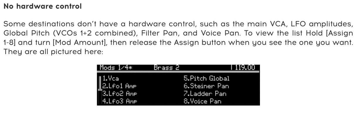

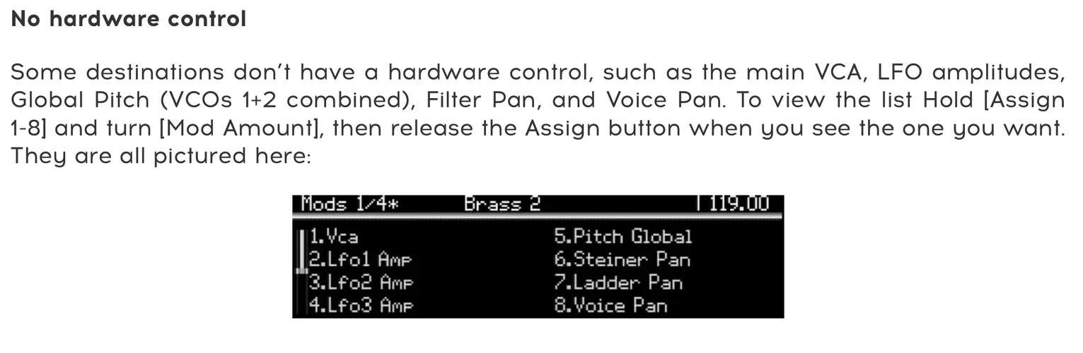

Gibt es eigentlich eine Liste von der Modulationsmatrix , Quelle und Ziel, damit nan mal eine Übersicht hat??
Mod Sources:
RowMOD sourceNotes
AVCF EnvOutput voltage of the VCF envelope
BMod EnvOutput voltage of the Mod envelope
CVoicesOutput voltage based on voice number
DLFO 1Output from LFO 1 (unipolar or bipolar, depending on the LFO setting)
ELFO 2Output from LFO 2 (unipolar or bipolar, depending on the LFO setting)
FLFO 3Output from LFO 3 (unipolar or bipolar, depending on the LFO setting)
GKey / SeqTriggers from the keyboard, the sequencer/arpeggiator, and incoming MIDI notes
HVelocityOutput voltage based on MIDI velocity value
IAftertouchOutput voltage based on key pressure
JWheel + XOutput voltage of the Wheel summed with Morphée axis X (must assign the Wheel to Matrix)
KRibbon + YOutput voltage of the ribbon controller summed with Morphée axis Y
LExp 2 + ZOutput voltage of Expression pedal 2 summed with Morphée axis Z
Destination kann fast jeder Knopf sein und dann noch ein paar Extras, wie hier beschrieben.
