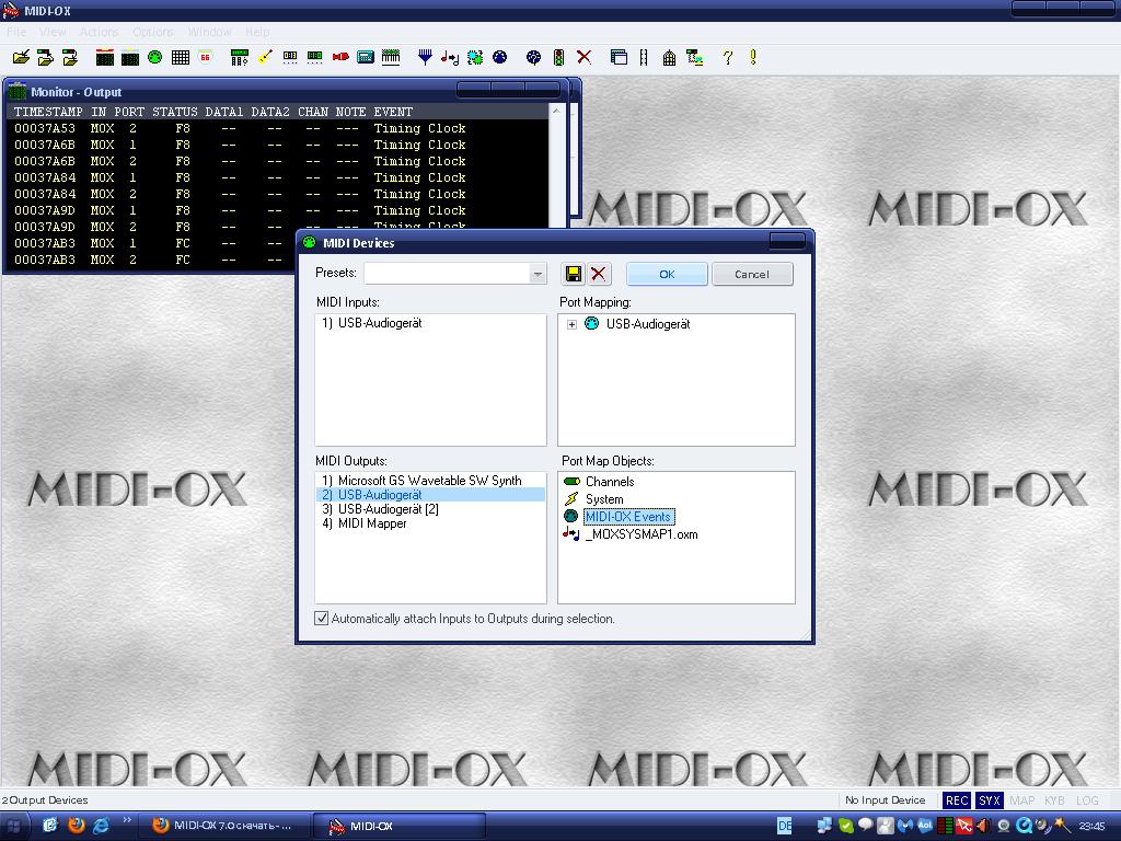

Thank you. I found this program on my computer.
1. It is very complex.
2. I do not see any possibility to open midi files.
I have no reason output. What could be wrong? I connected through a synthesizer USB.

No, MIDIOX is for anything. I love it. Show us your routing window in MIDIOX, probably you did not route correctly or activated some filters which block those events which you would like to keep.
MIDIOX has an automatic recording feature of any events which go through MIDIOX, these can be logged in text format, which you can convert with a command line or drag and drop tool into a normal .mid file which you can play later in any DAW/midi software. I even created for myself some tool which can split such midi files into smaller snippets, all with time stamps. All at the push of a single button. Thus this can give you a 'background recording feature' which you might know from Steinzeitdaw (stone age daw) Cubase, but now, for ANY source, be it hardware or software, anything what is routed through MIDIOX can have this 'automatic background recording feature with auto-splitting and timestamps'. For example if you use 2 or 3 different softwares in parallel, just route them together through MIDIOX, e.g. via MidiYoke, loopMIDI or similar, and your improvisations within those softwares will be saved, always, nothing is lost, all your ideas are there, even if you never pushed a record button, because MIDIOX offers this great feature. You only have to use it. Of course you can ignore it and try to use pd or other things, I did not ignore it. It is just perfect.
I use MIDIOX also for converting NRPN's to CC, so I can map those CC easily, e.g. in Reaper. Thus any hardware or software with NRPN output can also be used as a control device for other software parameters.
