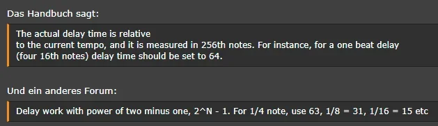

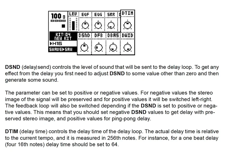

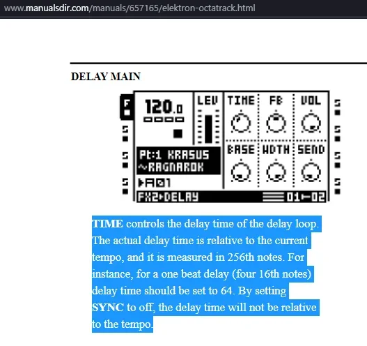

Das Handbuch sagt:
The actual delay time is relative
to the current tempo, and it is measured in 256th notes. For instance, for a one beat delay
(four 16th notes) delay time should be set to 64.

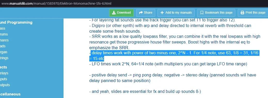

Und ein anderes Forum:
Delay work with power of two minus one, 2^N - 1. For 1/4 note, use 63, 1/8 = 31, 1/16 = 15 etc
