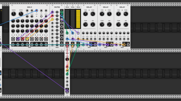

Dies ist die antwort von Empress Effects
Thanks for reaching out!
This can certainly be done with the Zoia with some clever patching. You could do this with a Sequencer controlling an Out Switch, and the outputs of the Out Switch routed to VCA CV inputs, where each effect is routed through a different VCA, and then all the VCAs outputs could be mixed together using an Audio Mixer module. Could be a very cool patch, though it will require some experimentation.

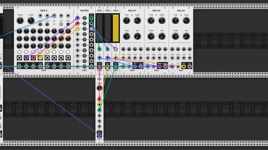

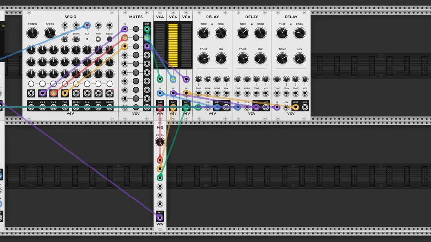

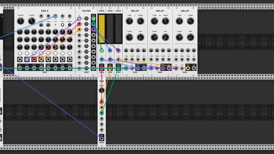

Mal ein basic patch - nach dem vorschlag von Empress Effects - sicherlich ausbaufähig
So viele module braut es garnicht...
Alles wie "gegated" - es fehlen natürlich übergänge der sounds...
