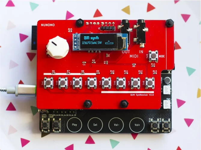

Bin gerade zufällig auf den QUN gestoßen. Erinnert mich vom Formfaktor erstmal direkt an den Korg NTS-1. Da steckt wirkliches einiges unter der kleinen Haube und ich finde der klingt (siehe YT-Demo) gar nicht so übel.
							 shop.nunomo.com
					shop.nunomo.com

				QUN Pocket Synthesizer
Based on ESP32 Lyrat development board, Qun is a powerful and unique pocket synthesizer. In general, cheap synthesizers don't have full flexibility because of hardware limitations. I was dreaming if I can get a small synth that has full flexibility of the real synth with an affordable price tag...
				 shop.nunomo.com
					shop.nunomo.com
Specs:
- Connectivity: Standard MIDI(TRS A type), BLE MIDI, UART MIDI(Supports MAC OS X and Windows through my SerialMIDI https://github.com/raspy135/serialmidi .
- ESP32 Lyrat- Originally designed for smart speaker.
- Analog Modeling engine- The analog modeling engine is made from scratch.
- All analog modeling engine parameters can be configured through MIDI.
- 2 Oscillators, it can be used as dual tone.
- Flexible MOD (CV) routing. The signal routing is very flexible, close to modular synthesizer experience. You can route signals as normal, or totally radical.
- AUX input can be used for external audio signal, or External CV input.
- 4 Envelove Generators
- FM (4 Operators x 2)
- 1 LFO, rate can be controlled by MIDI notes
- 1 Organic sounding VCF- 2/4 Poles, Low-pass, Band-pass, High-pass, Notch)
- Keysync
- 1 Effect (Delay, Chorus, Flanger)
- MIDI clock sync
- Advanced clipping algorithm makes organic clipping sound.
- Granular synthesis- One oscillator can be used as a granular synthesis engine.
- Player / Sequencer- Player (Piano mode)
- Random mind inspiring 8 step sequencer will generate beats for you- Note On/Off/Double/Triple
- Transpose / Note width(Length)
- Randomness control
- Scale quantize
- Arpeggiate steps
- Looper- Looper can record the sound up to 30 sec, synchronized with the sequencer.
- Play / Rec / Overdub
https://www.youtube.com/watch?v=QsnHaT9Xl84
