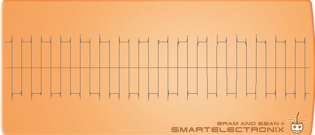

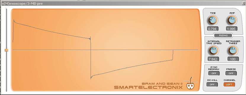

Rechteckwellen Cwejman komisch ?
There´s always some sort of wave modification due to the electronic components.
You can see it quite good when you hook the oscilloscope after a filter. Even if the filter is fully open, there´s a modification of the waveform. Same with VCAs etc... the more direct the path between VCO and oscilloscope the more accurate the result is.
Analog filters tend to saturate, depending on the input level, VCAs may clip...

verstaerker Good, similar wave! we have the same synthesizer.
Herr Schulz You are right , but I don t have any analog oscilloscope. however, we have tried to pass the signal through the less possible circuits.
Kommons.de : I was trying with the analizer spectrum voxengoSPAN, but depending of the values that I assigned in the scale of dB, the results varied a lot; From only to turn up the odd harmonics, until turns up all the harmonics with the slightly attenuated pairs harmonics . Another time the theory, the reality and the interpretation of a scale.
