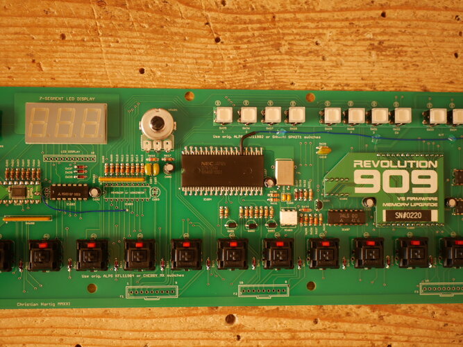

addictiveinstruments.fr
Revolution 909
The memory and display upgrade which allows the new firmware version you are waiting for the 40 last years!
