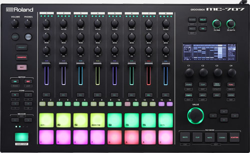

Roland MC-707 Groovebox (Firmware: V1.82)
Sammy3000
Sammy3000

S P E C S :
Sound Generator:
ZEN-Core (Tone,Drum Kit)
Track Type:
Tone, Drum Kit, Looper (Audio Loop)
Maximum Polyphony:
ZEN-Core:128 voices (varies according to the sound generator load)
LOOPER:8 (varies according to the available number of Looper track)
Tracks:
8 tracks
Clips:
128 clips (16 clips per track)
* Clip Type: Tone, Drum Kit, Looper (Audio Loop), it varies according to the track type.
Tones:
Preset Tone: 3,000 or greater
Preset Drum Kit: 80 or greater
User Sample (as a Tone or Drum Kit): available by importing form SD CARD
Looper Sample (as a clip of Looper track): available by importing from SD CARD, recording via EXT IN/Tracks
* Available total time for User Sample: 12 minutes in mono, 6 minutes in stereo (44.1 kHz)
* Available format of User Sample: WAV 32–96 kHz/16-bit, 24-bit (mono, stereo)
* Available total time for Looper Sample: Approx. 60 sec (44.1 kHz)
* Available format of Looper Sample: WAV 44.1 kHz/16-bit, 24-bit, 32-bit, 32-bit float (mono, stereo)
Effects:
Track Multi-Effects: 90 types
Track EQ
Chorus/Delay: 9 types
Reverb: 7 types
Master Effects: 90 types
Master Compressor
Master EQ
Step Sequencer:
Maximum Step: 64 steps
* Available on a Tone or Drum Kit Track
Looper:
Time Stretch, Pitch Shift
* Available on a Looper Track
Display:
256 x 80 dots graphic LCD (with backlit)
External Storage:
SD Card (SDHC supported) for saving Project Data and Audio Data
Connectors:
PHONES jack: Stereo 1/4-inch phone type
MIX OUT(L/MONO, R) jacks: 1/4-inch phone type
ASSIGNABLE OUT(L,R) jacks: 1/4-inch phone type
SEND/RETURN(L/MONO, R) jacks: 1/4-inch phone type
EXT IN(L/MONO/MIC, R) jacks: 1/4-inch phone type (it works as 1/4-inch TRS phone type when using MIC)
MIDI (IN, OUT1, OUT2) connectors
USB port: USB B type (Audio, MIDI)
DC IN jack
Power Supply:
AC adaptor
Current Draw:
2,000 mA
Accessories:
AC adaptor
Owner's manual
Leaflet "USING THE UNIT SAFELY"
SD Card (installed in the product when shipped from the factory)
SD Card Protector (installed in the product when shipped from the factory)
