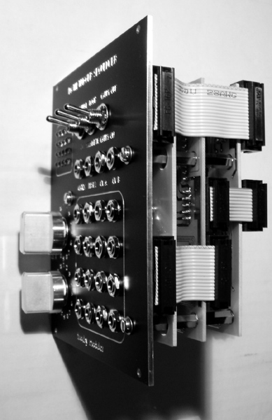

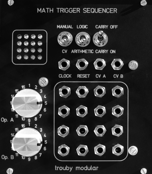

nach langer Zeit ist es soweit - der math trigger Sequencer mit CV ist fertig :nihao:
kurzbeschreibung englisch:
this binary module does really math:
two values are operated together and each result has his own output.
22 UE, 6 cm or 2,5" deep
- 2 variants to choose the 2 values: manual by the 2 rotary switches or by CV from 0 - 5V
- 3 operating modes: logical, arithmetical w/ or w/o carry
- values and result from 1 to 16
- each result has his own trigger pulse output of 4ms
good for triggering drums, envelopes, events...
