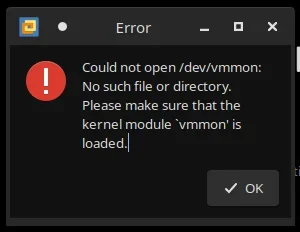

Jetzt noch den Hypervisor installieren und dann bion ich schon fertig.
Tja, schön wäre es gewesen
Das ist genau das was ich dann wieder nicht so mag...
Code:
In file included from /tmp/modconfig-DzZWe8/vmmon-only/common/vmx86.c:52:
2024-10-11T14:24:21.985Z In(05) host-31610 ./arch/x86/include/asm/timex.h: In function ‘random_get_entropy’:
2024-10-11T14:24:21.985Z In(05) host-31610 ./arch/x86/include/asm/timex.h:12:24: error: implicit declaration of function ‘random_get_entropy_fallback’; did you mean ‘random_get_entropy’? [-Werror=implicit-function-declarat>
2024-10-11T14:24:21.985Z In(05) host-31610    12 |                 return random_get_entropy_fallback();
2024-10-11T14:24:21.985Z In(05) host-31610       |                        ^~~~~~~~~~~~~~~~~~~~~~~~~~~
2024-10-11T14:24:21.985Z In(05) host-31610       |                        random_get_entropy
2024-10-11T14:24:21.985Z In(05) host-31610 /tmp/modconfig-DzZWe8/vmmon-only/common/vmx86.c: At top level:
2024-10-11T14:24:21.985Z In(05) host-31610 /tmp/modconfig-DzZWe8/vmmon-only/common/vmx86.c:700:1: warning: no previous prototype for ‘Vmx86FreeVMDriver’ [-Wmissing-prototypes]
2024-10-11T14:24:21.985Z In(05) host-31610   700 | Vmx86FreeVMDriver(VMDriver *vm)
2024-10-11T14:24:21.985Z In(05) host-31610 /tmp/modconfig-DzZWe8/vmmon-only/common/vmx86.c:733:1: warning: no previous prototype for ‘Vmx86AllocVMDriver’ [-Wmissing-prototypes]
2024-10-11T14:24:21.985Z In(05) host-31610   733 | Vmx86AllocVMDriver(uint32 numVCPUs)
2024-10-11T14:24:21.985Z In(05) host-31610 /tmp/modconfig-DzZWe8/vmmon-only/linux/hostif.c:2926:1: warning: no previous prototype for ‘HostIFCheckTrackedMPN’ [-Wmissing-prototypes]
2024-10-11T14:24:21.985Z In(05) host-31610  2926 | HostIFCheckTrackedMPN(VMDriver *vm, // IN: The VM instance
2024-10-11T14:24:21.985Z In(05) host-31610 /tmp/modconfig-DzZWe8/vmmon-only/linux/hostif.c:3046:1: warning: no previous prototype for ‘HostIFWritePhysicalWork’ [-Wmissing-prototypes]
2024-10-11T14:24:21.985Z In(05) host-31610  3046 | HostIFWritePhysicalWork(MA ma,             // MA to be written to
2024-10-11T14:24:21.985Z In(05) host-31610 /tmp/modconfig-DzZWe8/vmmon-only/linux/hostif.c:3205:1: warning: no previous prototype for ‘HostIFStartTimer’ [-Wmissing-prototypes]
2024-10-11T14:24:21.985Z In(05) host-31610  3205 | HostIFStartTimer(Bool rateChanged,  //IN: Did rate change?
2024-10-11T14:24:21.985Z In(05) host-31610 /tmp/modconfig-DzZWe8/vmmon-only/linux/driver.c:271:1: warning: no previous prototype for ‘LinuxDriverInit’ [-Wmissing-prototypes]
2024-10-11T14:24:21.985Z In(05) host-31610   271 | LinuxDriverInit(void)
2024-10-11T14:24:21.985Z In(05) host-31610 /tmp/modconfig-DzZWe8/vmmon-only/linux/driver.c:339:1: warning: no previous prototype for ‘LinuxDriverExit’ [-Wmissing-prototypes]
2024-10-11T14:24:21.985Z In(05) host-31610   339 | LinuxDriverExit(void)
2024-10-11T14:24:21.985Z In(05) host-31610 /tmp/modconfig-DzZWe8/vmmon-only/common/task.o: warning: objtool: .text: unexpected end of section
2024-10-11T14:24:21.985Z In(05) host-31610 cc1: some warnings being treated as errors

Ubuntu 18.04 Du hast doch Ubuntu Studio 24.04.1 LTS oder Ubuntu Studio 24.10 installiert, oder?
Das "vmmon" Module hast du mal händisch geladen?
Ubuntu benennt die Versionen im Format Jahr.Monat, dh Version 18.04 ist von 2018- Seitdem hat sich wirklich viel getan, u.a. eben pulseaudio, das einem viel Stress erspart.
Versuchst Du, Windows in einer VMWare-Instanz unter Linux zu betreiben?
Versuch doch vielleicht mal Wine als die Linux-eigene Emulationslösung, das ist vermutlich besser integriert.

Steht im Eingangspost. Alle Rechner auf einer Hardware mit Linux als Host. Die anderen Rechner (Windows) habe ich virtualisiert. Das ging halt mit VMware am einfachsten.
Einfacher als "sudo apt install virt-manger" und dann "virt-manger"? ( möglicherweise den Benutzer noch der entsprechenden Gruppe zufügen) Mehr brauchts nämlich nicht um dann die kvm Virtualisierung zu nutzen. Denk dran, das Du das VMware Modul bei jedem Kernel(sicherheits)update händisch neu compilieren musst...
  • #29
Also wenn jemand weiß wie ich das sauber kompiliert bekomme würde ich mich über eine Hilfestellung freuen. Daran hängt es gerade. Noch habe ich keine Lösung gefunden.
Ansonsten ist es eben virtualisierte Hardware. Ich kann die auch gern noch mal für eine andere Plattform virtualusieren. Aber am einfachsten war das halt mit dem VMware Converter.
Proxmox kann das über Umwege auch. Aber das ist mir einfach zu aufwendig. So viele plattformunabhängige Lösungen gibt's ja leider nicht. Also ist es VMware geworden.
