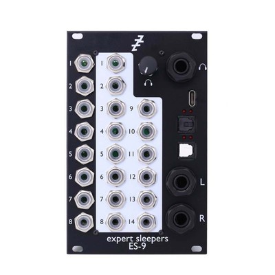

Specifications
The ES-9's specifications are as follows:
  • Panel width: 16HP
  • Module depth (including power cable): 50mm
  • Current draw: 451mA on the +12V rail, 133mA on the -12V rail (at 96kHz)
  • USB socket: Type C
  • Driver suport: class-compliant USB 2.0 (no driver required for macOS and iOS - Windows drivers provided for Windows 7, 8 & 10)
  • Channel count: 16 in, 16 out
  • Supported sample rates: 44.1kHz, 48kHz, 88.2kHz, 96kHz
  • Audio sample depth: 24 bit
  • Analogue outputs:
    • 8x 3.5mm TS jacks, DC-coupled, Maximum output voltage approximately ±10V
    • 2x 1/4" TRS balanced jacks, AC-coupled (main outs)
    • 1x 1/4" TRS stereo jack, DC-coupled (headphones)
  • Analogue inputs:
    • 14x 3.5mm TS jacks, DC-coupled, Input voltage range approximately ±10V
  • Digital I/O: 1x S/PDIF input (TOSlink), 1x S/PDIF output (TOSlink)
  • MIDI I/O: 1 input, 1 output (on breakout)
  • Expansion headers: 1 for ES-5, 1 for MIDI breakout
  • Panel controls: headphone volume
  • Internal mixer: 8x8 crosspoint mixer
(469€)
