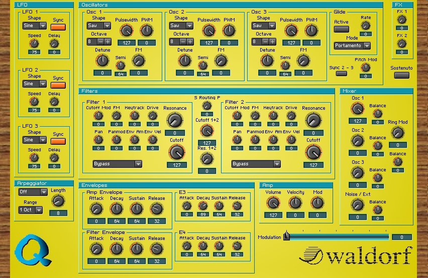

Hab grade bei der Suche nach meiner Q/XTk Input Frage folgendes gefunden, ein nicht unkomplizierter aber interessanter Ansatz.
NI Reaktor zur Midi Steuerhure zu degradieren:
Total Recall für unsere alten Hardwareteile :)
Q: How to control the Q via a Reaktor ensemble and Cubase SX? -> Q Ti ;-)
A: To use you will need at least Reaktor 5 and Cubase SX 3.1 (and a Q obviously)
Load Reaktor as a VSTi and load up the Q TI.ens file below.
To use the file you will need two tracks in SX both midi outputs set to your Q.
Set the midi in on one track to your usual controller keyboard or just choose all inputs.
On the other track select Reaktor as the midi input.
Arm both tracks and your away.
You can use all 16 midi channels using the same .ens but be careful when using snapshots as you may find yourself changing things inadvertently that you have not adjusted. I will try to work out a better way of multi channel use.
Darren
Link:
http://faq.waldorfian.info/files/Q_TI.ens
