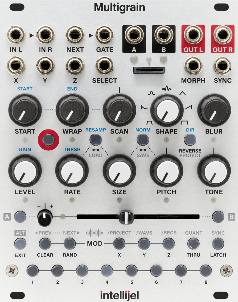

Neues Firmware Update mit umfangreichen Änderungen und Ergänzungen. Choke und Gate Sound klingt super nützlich!
1.4.1 (2026-04-27)​
  • New: 2 New Per-Sound Options — Enable any combination of these.
    Note: the Blur effect is not choked or gated and will decay as expected.
    1. Choke Sound
      Choke Sounds will cut off any existing grains when they are triggered.
    2. Gate Sound
      Gate Sounds will instantly end any existing grains when the "gate" goes low; the "gate" can be the GATE input, holding the SOUND button down, or latching the sound.
  • New: Alt Page UI for Per-Sound Options: Live, Choke, Gate
    Note: The existing Home Page Toggle for Live Sounds (SOUND+SAMPLE) is still active.
    1. Enter the ALT page and hold the SOUND button down to view or tweak that Sound.
    2. The 4 LED Buttons in the Grain Section will change function while the SOUNDis held to show and toggle the Sound Options.
      • SAMPLE will toggle Live (Toggle Live Sound)
      • LINK/LOAD will toggle Choke (This still stop any audio before this Sound is fired)
      • LINK/SAVE will toggle Gate (This will stop any audio when the gate on this sound is released)
      • REVERSE is currently disabled in this context
    • You can hold LATCH along with any SOUND to set these options for all Sounds
    • New Choke and Gate Sound options can be saved with the default Sound or default Live Sound.
    • These options are saved in your preset.
  • New: New MOD A/B Output Options
    1. Threshold Gate (YELLOW)
      Follows the Record Threshold option, sends a gate when the input signal has passed the threshold; if threshold is disabled it uses the minimum value, this can be sensitive based on what is patched, just increase threshold if too sensitive. Try self-patching to GATE to have it sounds play only when audio is received by multigrain! Taking this further, you can also use it with the NEXT=RESET System option to re-align the playheads (to START) when new audio is captured.
    2. Record Trig (PINK)
      • If Sampler: Sends a trig when Recording Starts, great for triggering modules and recording a 1 shot.
      • If Looping Recorder (when using Live Sounds): Sends a trig when the recorder is recording, and goes low when it's frozen or waiting for audio.
  • New: System Page Options
    1. Grain Size Scaling
      Toggle ON to automatically reduce the range of SIZE as RATE is increased, otherwise grains will auto-fade when they need to be repurposed. Note: This setting used to be tied to the Max Grain Size option (the top 3 settings had Auto-fade by default) and now has its own toggle; when upgrading, Multigrain will select it's option based on your size setting.
    2. Gate Delay
      This will delay the GATE signal to allow slower CV sources to catch up before a Sound is triggered. Use START on the System Page to add up to 8ms to the internal Gate Delay, full CCW is the minimum (default). (For example, the Arturia Keystep may require a higher delay for Pitch CV to respond in time with the gate).
  • New: Independent THRSH settings for Looping Recorder and the (Re)Sampler
    Setting threshold will be specifc to your RESAMP selection; then the Looping Recorder is selected on the Sample Settings page, you will be adjusting the threshold for the Looping Recorder, any other selection will set the threshold for the Sampler. The THRSH LED colours will change to match your RESAMP selection. Note: When upgrading, Multigrain will set both values to your old threshold value.
  • Tweak: Changes to auto-fading algorithm for smoother fades.
  • Tweak: Optimizations/performance increases in grain engine.
  • Tweak: Increase grain engine output level.
  • Tweak: Increased max gain for Input Gain from 2.5x (~8dB) to 8.5x (~18.5dB) — The Input Gain setting will reset to 1x (Noon) when you load this update. Note: that this is digital gain and will boost your noise floor. Analog gain is always recommended to boost quiet sources into digital modules.
  • Fixed: If RESAMP was enabled, and there was no Live Sounds, it would not activate properly on boot.
  • Fixed: Theme Changes were not being saved. (Allow 10sec or so after boot for the change to save to SD).
  • Fixed: Sound default may not have loaded if assigning a sound straight from the recorder.
  • Fixes/Tweaks: Minor bug fixes and tweaks.
