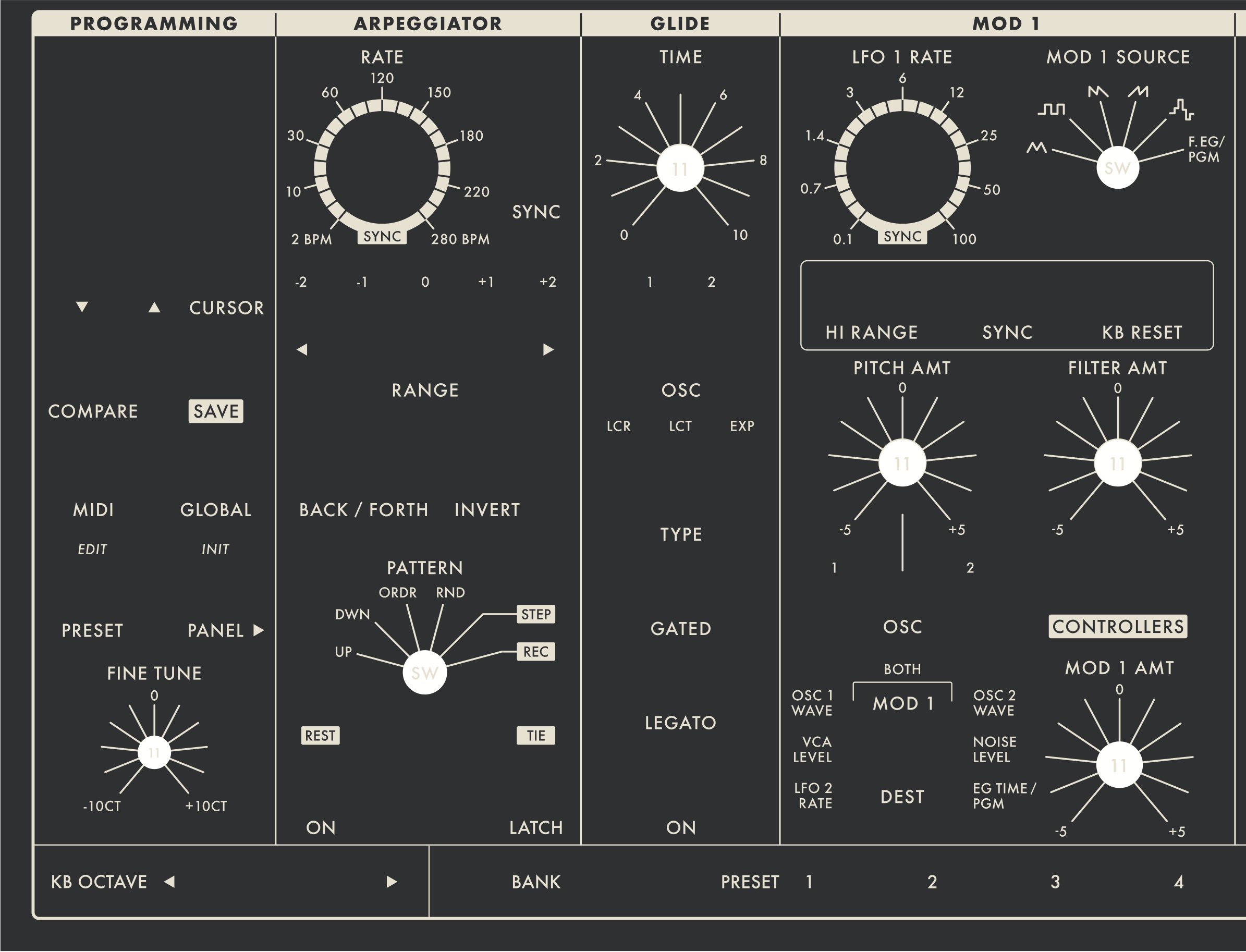

Ja, also hier erstmal eine Liste mit den Modulationszielen (ich erlaube mir einfach mal, einen Gearslutz-Beitrag von Amos zu zitieren):
Sub 37 Mod Destinations:
available on the panel are the following 7 items:
LFO Rate (on Mod Bus 1, the destination is LFO 2 Rate; on Mod Bus 2, the destination is LFO 1 Rate)
VCA Level
Osc 1 Wave / Osc2 Wave / Both
Noise Level
"PGM" (Programmable Destination)
There are about 90 programmable destinations. This list might have a couple of errata, but it's mostly correct:
Mod Destinations:
EG Times [default]
Filter_Resonance
Filter_Drive
Filter_Slope
Filter_EG_Amt
Filter_KB_Amt
Osc1_Level
SubOsc_Level
Osc2_Level
Fb_Ext_Level
Osc1_On
SubOsc_On
Osc2_On
Noise_On
Fb_Ext_On
Arp_Rate
Arp_Clk_Div
Arp_Range
Arp_Back_Forth
Arp_BF_Mode
Arp_Invert
Arp_Gate_Len
Arp_Run
Glide_Time
Glide_Osc
Glide_Type
Glide_Gate
Glide_Legato
Glide_On
LFO1_Clk_Div
LFO1_Range
LFO1_Sync
LFO1_KB_Reset
LFO1_Phase
LFO1_DutyCycle
LFO1_KB_Track
Mod1_Pitch_Amt
Mod1_Filter_Amt
Mod1_Pgm_Amt
Mod1_Pitch_Dest
LFO2_Clk_Div
LFO2_Range
LFO2_Sync
LFO2_KB_Reset
LFO2_Phase
LFO2_DutyCycle
LFO2_KB_Track
Mod2_Pitch_Amt
Mod2_Filter_Amt
Mod2_Pgm_Amt
Mod2_Pitch_Dest
Osc1_Octave
Osc2_Hard_Sync
Osc_KB_Reset
Osc2_Octave
Osc2_KB_Ctrl
Osc2_Duo_Mode
Osc2_Frequency
Osc2_Beat
F_EG_Attack
F_EG_Decay
F_EG_Sustain
F_EG_Release
F_EG_Delay
F_EG_Hold
F_EG_Vel_Amt
F_EG_KB_Track
F_EG_MultiTrig
F_EG_Reset
F_EG_Sync
F_EG_Loop
F_EG_Latch
A_EG_Attack
A_EG_Decay
A_EG_Sustain
A_EG_Release
A_EG_Delay
A_EG_Hold
A_EG_Vel_Amt
A_EG_KB_Track
A_EG_MultiTrig
A_EG_Reset
A_EG_Sync
A_EG_Loop
A_EG_Latch
Output_Volume
Bend_Up_Amt
Bend_Down_Amt
Die Modulationsziele sind Folgende:
AMP EG: Amplitude Envelope Generator
CONST ON: Constant On
SINE LFO: Extra Sine Wave LFO
NOISE LFO: Extra Noise LFO
OSC1 PCH: Oscillator 1’s Pitch OSC2
PCH: Oscillator 2’s Pitch
SEQ NOTE: Current Note of the Sequencer
SEQ VEL: Current Velocity of the Sequencer
SEQ MOD: Mod Wheel Amount Stored In Sequence Step
Um gleich mal das Rätsel um CV Pitch als Modulationsquelle zu lösen: Wenn man beispielsweise Osc 1 Pitch auf Oszillator 2 anwendet, wird ganz einfach nur die Tonhöhe von Oszillator 2 in Abhängigkeit von der Tonhöhe des ersten Oszillators beeinflusst, hat also gar nichts mit FM zu tun. FM geht aber einigermaßen mit den schnellen LFOs im Zusammenspiel mit Keytracking. Ich werde bald mal ein klassisches Beispiel hochladen (so was wie einen Glocken-Sound).
Zu Deiner letzten Frage:
Ja, der Step-Sequenzer ist nutzbar und das sehr, sehr einfach. Nur die Preset-Taster sind noch nicht als Step-Taster zu benutzen. Das wird aber alles mit kommenden Firmware-Updates kommen.
Grundsätzlich gilt, dass der Sub 37 auch ohne Anleitung ganz einfach zu bedienen ist. Obschon die Liste ganz oben erschlagend wirkt, ist doch die Nutzung des Menüs sehr einfach solange man weiß, wonach man suchen kann. Das Menü ist überdies sehr rudimentär aufgebaut, d.h. es gibt keine komplizierten Verästelungen darin. Es ist wirklich nur eine Hilfestellung für alles, was nicht auf's Panel passte. Der Sub 37 lässt sich also sehr intuitiv handhaben.
Was übrigens auch noch mit kommenden Updates kommen wird, ist, dass man die LED- und Display-Beleuchtungsintensität nach eigenem Gusto wird regeln können.

Die zuletzt gelisteten sind die Modulationsziele (die kürzere Liste) und die lange Liste umfasst die erweiterten Modulationsquellen und die sind wiederum, das ist richtig, über MOD 1/2 SOURCE und dann F. EG/PGM anzuwählen. Um die entsprechenden Modulationsquellen festlegen zu können, drückst Du dann einfach die Taste über der CONTROLLERS-Beschriftung und schon gelangst Du ins entsprechende Menü. So funktioniert das übrigens mit allen spezifischen Menüseiten: es gibt für jede eine entsprechende Taste auf dem Bedienfeld, weshalb es auch nie unübersichtlich werden kann.
Der Sequenzer und Arpeggiator laufen von 2 bis 280 BPM (damit bist Du noch nicht im Audiobereich). Und nein, beide sind auch nicht kombinierbar. Die weiß unterlegten Beschriftungen im Sequenzer/Arpeggiator-Bedienfeld (Step, Rec, Rest, Tie) sind für den Sequenzer, der Rest ist für den Arpeggiator. Du kannst aber die LFOs zum Sequenzer synchronisieren (halbe, selbe, doppelte Geschwindigkeit) und darüber noch ein paar Tonhöhenmodulationen einbringen (zusätzlich zum Sequenzer) - z.B. über Sample and Hold oder Rechteck. Darüber hinaus sollte man nicht die zusätzlich noch loop-baren Hüllkurven vergessen (auch synchronisierbar), die - so wie die LFOs - auch in den Audiobereich gehen.
Eine LFO kann auf Pitch (entweder Oszillator 1 oder Oszillator 2 oder beide), Filter und auf eines der frei wählbaren weiteren Modulationsziele wirken (Osc 1 Wave, Osc 2 Wave, Osc 1 & Osc 2 Wave, Noise Level, EG Time/PGM, LFO 2 Rate, VCA Level). Das macht pro LFO bis zu drei Ziele gleichzeitig.
Ich hoffe, das hilft weiter.

@serenadi:
Bei Moog sind im Gegensatz zu anderen Synths immer 3 (bzw. 4) Parameter bei Modulationen im Spiel. 1) Source, 2) Destination, 3) Controller (und 4) der maximale Amount).
Historisch hängt der Modbus immer am Modwheel, beim Sub37 geht natuerlich mehr.
Also zB.: LFO auf Filter
LFO ist die Source, Filter, die Dest., Controller ist Modwheel, Amount bestimmt die maximale Intensität bei vollem Mod-Wheel Anschlag.
Also sind Velocity, Aftertouch etc. in der Regel Controller und nicht Mod Sources.
Will man keine Source wie LFO wählt man fixed Voltage als Source.

Nein, diese direkten Routingmöglichkeiten von Aftertouch oder Modwheel zu LFO gibt es nicht bei Moog. Du kannst aber zwischen 0 und 100% die Zugriffsintensität von Modwheel oder Aftertouch oder beidem festlegen. Du entscheidest selbst, welcher LFO wie stark vom Modwheel oder Aftertouch gesteuert wird. Wenn Du beispielsweise ein Patch auf dem Sub 37 initialisierst, ist die Standardeinstellung, dass nur LFO 1 zu 100% auf's Modwheel gelegt ist, während LFO 2 frei läuft, d.h. unmittelbar aktiv wird, sobald Du einen Zielparameter hochfährst. Wie gesagt, ist das aber alles frei einstellbar.

Ok, ich glaub' ich hab's. Danke.
Für velocity hat man also 4 Ziele: die beiden ENVs und die Modulation der Mod 1&2 Busse.
Das war im ersten Moment nicht klar, daß es das Controller-Menu für jeden ModBus separat gibt.
Aftertouch beschränkt sich dann nur auf die beiden Mod-Busse.
Da sind 2 Busse ja schon ein wenig knapp. Allein durch z.B. ein Vibrato auf dem Modwheel und Cutoff vom Aftertouch gesteuert sind die Modbusse samt LFO's belegt.
Will man die vibrato-rate tonhöhenabhängig haben, ist auch schon der 2. Modbus weg.
D.h. Pitch Amnt, Filter Amnt und Mod1 Amnt werden alle gleichzeitig von dem (oder den) ausgewählten Controller(n) beeinflusst?
Nach dem Motto *weniger ist mehr* wird man sich hier wohl modulationsmäßig auf's wesentlichste "begnügen" müssen.
LG
Bernd

Ich glaube, eine einfachere Art, die Verbindung zwischen beispielsweise Modwheel und Aftertouch zu den LFOs zu denken ist, dass die Verknüpfung immer schon hergestellt ist. Das ist modular gedacht so, als seien Aftertouch und Modwheel immer schon mit der Steuerung für die LFO-Intensität verkabelt. Du bestimmst nur, zu welchem Grad die LFOs durch diese Steuerungsquellen beeinflusst werden - also entweder gar nicht oder irgendwas zwischen 1 und 100%.
Und klar, das ist kein DSI-Synth. Ob die man die Modbusse allerdings unmittelbar als zu knapp empfindet, ist eine andere Sache. Vielleicht sieht das auf dem Blatt Papier alles nach etwas wenig aus, aber man kann recht schnell zu ziemlich komplexen Sounds kommen. Wenn du dann noch überlegst, was evt. musikalisch noch sinnvoll sein soll, ist ein Modulations-Ende vielleicht nicht so schnell erreicht, wie Du jetzt vermutest. Außerdem sind alle Knöpfe auf dem Panel schließlich auch Controller. Es gibt ja nicht nur Modwheel und Aftertouch.
Und denk mal allein an das Zusammenspiel von Sequenzer/Arpeggiator (kann man ja beide auch zweckentfremden) und den 2 loopbaren Hüllkurven. Damit kriegst du schon mal einen auf drei Ebenen erzeugten Polyrhythmus hin, wenn alle auch nur leicht verschoben, d.h. nicht synchronisiert sind.
