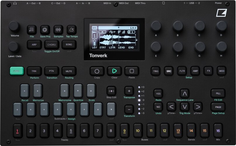

Ich könnte mir vorstellen, daß die Pages über die Okatvschalter umgeschaltet werden. Subtracks könnten für mehrere Drumsounds auf einem Track genutzt werden....
Anhang anzeigen 263508Anhang anzeigen 263509
SPECS:

Elektron Tonverk
Audio & Tracks:
8 × stereo audio tracks
4 × bus tracks
3 × send effect tracks
1 × mix track
4 selectable machines per audio track: Single Player, Multi Player, Subtracks, MIDI (also for bus tracks)
1 × digital filter per track/subtrack
2 × assignable LFOs per audio track
2 × assignable FX LFOs per audio track
1 × modulation envelope per audio track
2 × assignable LFOs per effects bus, send effects & mix
Modulation per track: Pitch Bend, Mod Wheel, Breath Control, Aftertouch
16x polyphony per step per MIDI track
16 assignable CC controls per MIDI track
2 × assignable LFOs per track per MIDI track
2 × Trig modes
Velocity per step
Keyboard mode with 36 scales
Song & Chord Mode
Up to 256 steps per pattern & track
Arpeggiator for audio & MIDI tracks
Polyphonic sequencing
Individual pattern length per track
Individual time scale multiplier per track
Parameter Locks
Trig Conditions & Trig Chance
Retrig (Audio & MIDI)
Micro timing & sequencer lanes
128 × 64 px OLED display
SD card slot
Robust steel housing
100 × 100 mm VESA mount (M4, max. 7 mm screw length)
48 kHz, 24-bit D/A & A/D converter
Class-Compliant USB Audio
External input mixer with routable outputs
Dimensions: 286 × 176 × 63 mm (including knobs/feet)
Weight: approx. 1.85 kg
Effects (track dependent, see manual):
Comb ± Filter
Filter bank
Lowpass & Multimode Filter
Infinite Flanger
Panoramic Chorus
Phase 98
Warble
Chrono Pitch
Frequency Warper
Compressor
Degrader
Dirtshaper
Daisy Delay
Saturator Delay
Rum Sound Reverb
Supervoid Reverb

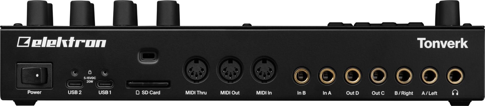

Connections:
4 impedance-balanced audio out 6.3mm jack
2 balanced audio in 6.3mm jack
1 stereo headphone output 6.3mm jack
2 × USB-C ports
MIDI In/Out/Thru with DIN Sync Out
Scope of delivery:
64 GB SD card
PSU-5 power supply
Elektron USB-C cable
Exclusive artwork
This is a machine ready for adventure: an instrument that propels you to extraordinary music-making and limitless sonic exploration. Tonverk is both a pioneering pathfinder and a wondrous labyrinth you can immerse yourself in—with diverse possibilities for capturing, editing, and routing your sound.
It may be:
… your versatile polyphonic sampler.
… your routing playground.
… your FX mixer.
… your machine with tracks within tracks.
… your multitonal sound factory.
Tonverk offers eight audio tracks that can be used in different ways depending on your creative goals. Plus, there are four bus tracks, three send tracks, and a mix track – perfect for flexible routing and a wealth of fresh effect sounds that you can use anywhere in the device. This opens the door to fantastic fun and limitless experimentation. And as with any adventure, the beginning is just a taste of what's to come.
Tonverk offers a wide selection of effects—including many new features. Plenty of modulation, extensive routing options (internal and external), and two sampling types:
Recorder – for direct audio sampling, external or internal
Auto Sampler – use MIDI to automatically multisample your favorite instruments
There are also numerous other features, including the proven Elektron workflow optimizations.
Machines per audio track:
SINGLE PLAYER
Play individual WAV files (mono or stereo) polyphonically. Adjust playback behavior, set loop points, and use crossfade for seamless looping—and much more.
Multiplayer
Load a multisampled instrument from the Tonverk library and play it polyphonically. You can also create your own multisamples with the Auto Sampler.
SUBTRACKS
Add eight monophonic, multitimbral subtracks to a track—each with its own sample, sequencer, and individual parameters. 8-in-1!
MIDI
Convert the selected track into a MIDI track.
