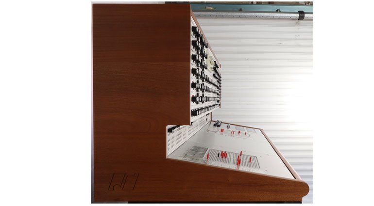

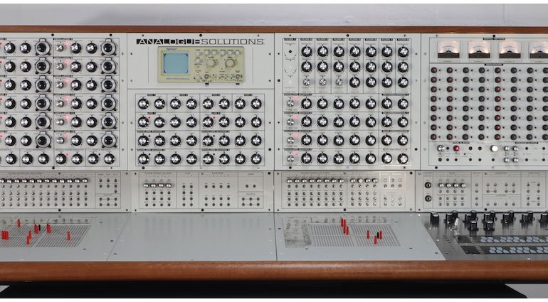

Analogue Solutions Colossus hat 12 Oszillatoren, 32×32 Ghielmetti (CH) Matritzen, 8 Multimode-Filter, 12 VCAs, einen 64-Step Sequencer, 2 Sechskanal-Mixer, 2 Joysticks und 2 Keyboards. Er ist 1, 7 m x 0,7 m x 0,65m groß und kostet £20.000 und basiert auf bisherigen Analogue Solutions Entwicklungen wie Polymath und Co – Es ist also kein Clone oder Nachbau des Synthi 100 – das größte Problem des baldigen Besitzers dürfte logistischer Natur sein. Und vermutlich wird es keinen anderen Hersteller geben, der das alles billiger macht.

  1. 12x analogue VCO (/LFO)s with 4 waveforms
    pulse width, sync, sub-osc
    ability to go down to low frequencies. Precision control using high-quality multi-turn vernier dials.
    sample & hold generator
    random voltage generator
    2x white/pink noise generators
    multiple
    analogue CRT oscilloscope
    2x LFOs in addition to the VCOs
    4x VCA in addition to the VCF VCAs
    4x ASR envelopes
    multiple
    VCOs can be used as LFOs. So Colossus has, in fact, a potential total of 16 LFOs!
    each of the 8 VCFs have VCAs hard-wired inline, so these plus the individual VCAs means there are in fact a total of 12 VCAs!
    4x multimode filters (low, band and high pass 12dB filters, each with serial VCAs
    4x lowpass filters – 24dB transistor ladder filters, each with serial VCAs
    8x VCF/VCA combinations in total)
    2x analogue mechanical spring reverbs, each one feature a triple spring tank
    2x ring modulators
    2x voltage slew generators
    4x ADSR with repeat and hold-repeat feature
    4x large signal level meters with backlit
    64 step / 2x 32 step analogue V/gate sequencer with clock generator, glide, jump, reset, CV, gate
    6 channel stereo audio mixer with level, pan and mute
    2x joystick controllers
    2x touch keyboards with digital note sequencers
    2 broadcast quality CV and audio pin matrix panels
    4 minijack patch panels, providing I/O from all circuits
