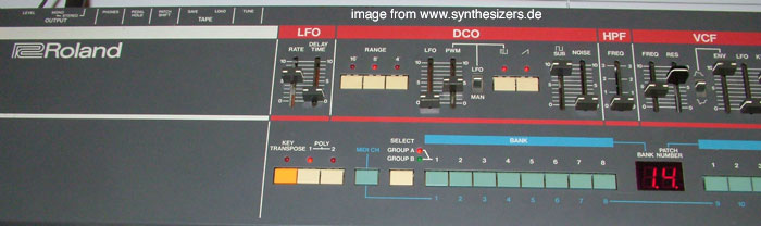

Roland Juno series juno-6,juno-60,juno-106:
Alpha Juno see below!
here with FX/hier mitEin einfaches System: DCO-VCF-VCA.. nicht so voll/voluminös wie SH101 und eben mit DCOs.. aber ähnliche Struktur.. trotzdem immer wieder im Umlauf – selbstresonante filter
die modelle juno60 und juno106 haben als unterschied speicher und der 106er midi.
simple DCO-VCF-VCA.. but self resonating 24dB/oct lpf filter 1 VCO with subosc, PWM, white noise and static 4 step hpf.
some quite similar to the juno6
the juno series are the juno60 and juno106 that have memory for patches. the juno 106 is simply a juno 60 with more midi and memory capability.
this is the simplest model: no midi and no memory ;)
little tips: on the juno60 you can press the patch buttons 5 and 1 or 2 simultaneously! this frees up 19 (!!) more patch memories!
want mono/uni mode on the juno? just press key transpose while power up (hold!) and you will hear all 6 notes to the last key held down! ;)
there are some test programs on board, that can be reached by 5 (hold down when you have plugged something into the patch select jack, then 4 or 5 for bank 8 and 9.
