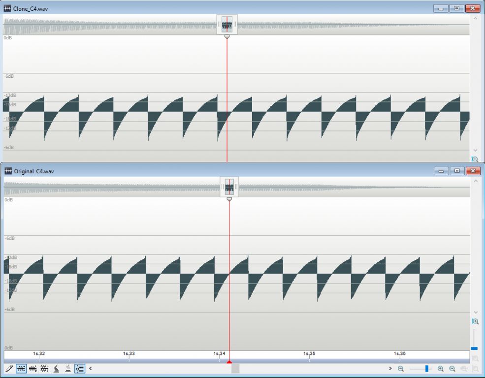

The next sound file is a comparisson of the original's saw sound and the SMD clone's voice board
View: http://soundcloud.com/boo-gie-879149310/originalvsclonec1c4
The below screen dumps show a comparisson of the original's saw wave and the clone's saw wave for C1 and C4

All 8 VCF's and 8 VCO's and 8 ADSR's are real time calculated.
Hey, does this mean you are creating the VCOs / VCFs digitally?
Or did I misunderstand that sentence.
The waveforms are looking nice either way :)
Curious to hear updates on this, please keep on posting here!
No, fortunately it doesn't.
VCO's are almost 100 % original jupiter 8, for the VCF I reconstructed the IR3109 with analog parts.
The sound comparisson is in this 'Filter_Compare_6' sound file above.
It's all analog, the only thing digital is the creation of the control voltages for the filters.
The complete audio generation, filter and VCA path is all analog.

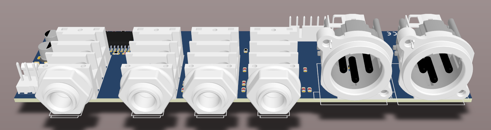

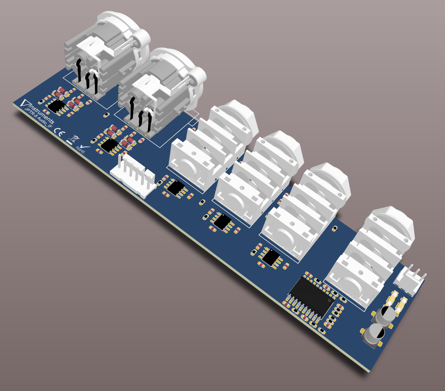

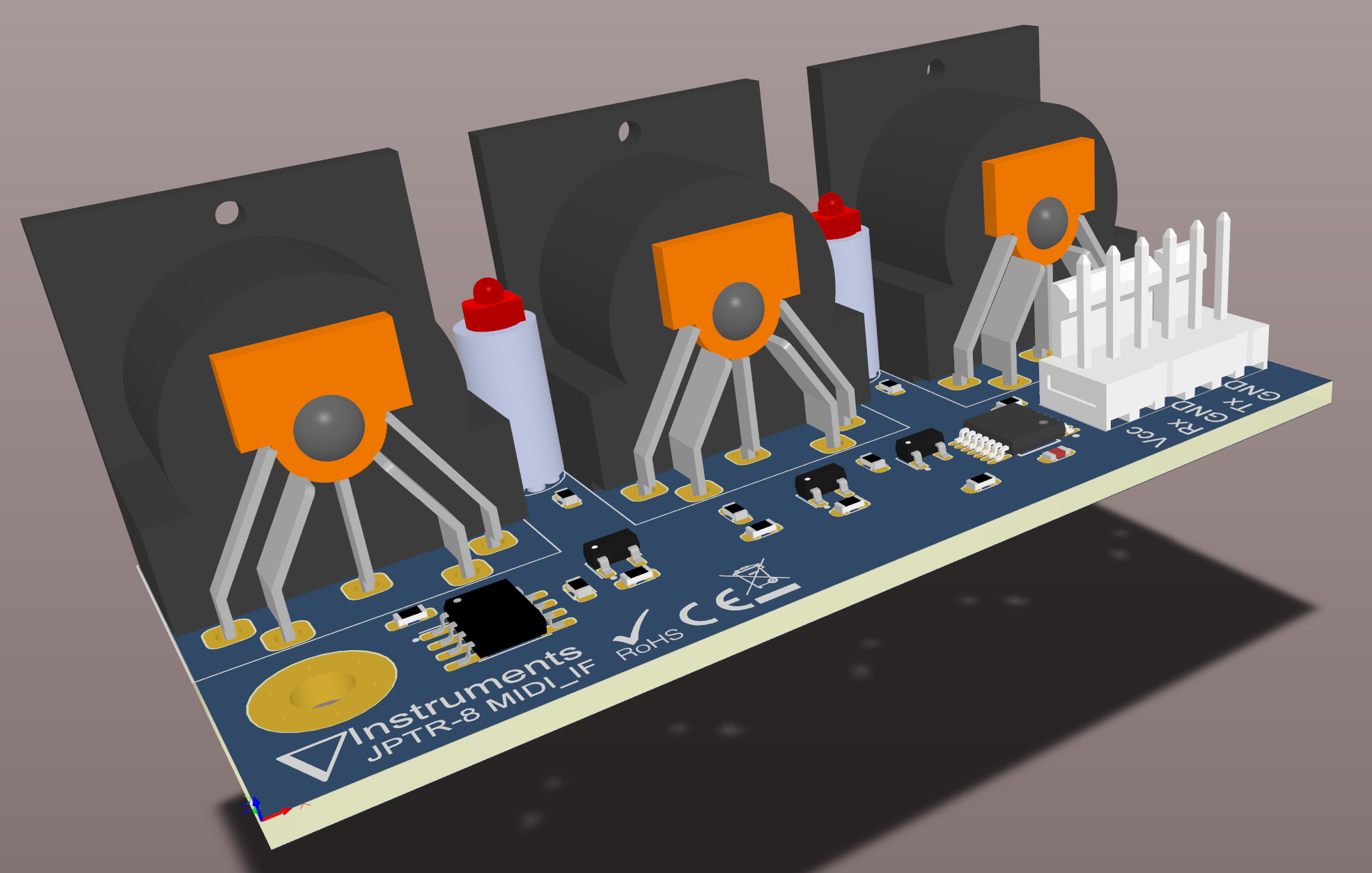

Hello all,
just to keep you a bit updated about the progress.
The JPTR-8 will provide a stereo audio image with 2 differential XLR Pro-audio outputs build around the THAT 1646 differential drivers and 3 Jack outputs for Left, Right and Mono.
An additional Pro-audio Headset output is also foreseen.
All Jack outputs are independent buffered.
The board contains power supply filtering and has separated analog GND and Chasis GND.
EMC filtering is foreseen on all outputs except the Headset output.
Overvoltage protection on the differential outputs has also been foreseen to protect the drivers agains faulty connection to a mic. input with fantom supply switched on.
Below some renders of the Audio IF board and the MIDI IF board.

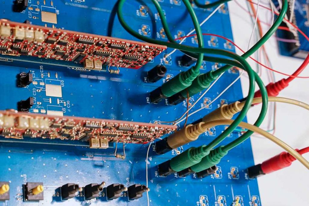

Hallo Leute,
hier gibt es wieder eine update, aber im English....
A preliminary picture of the prototype voice boards on the debug board below,
and two sound files using the two Voice Boards.
The second one is a sound scape containing some artifacts and noise in part two,
but pls listen to the sounds and try to avoid listening to the artifacts.
The first file contains some sounds like mentioned in the timestamps I've added.
Enjoy !
Dual notes a quint apart, thus two oscillators per note, and further UNISON, thus four oscillators per note, tuned and slightly detuned.
