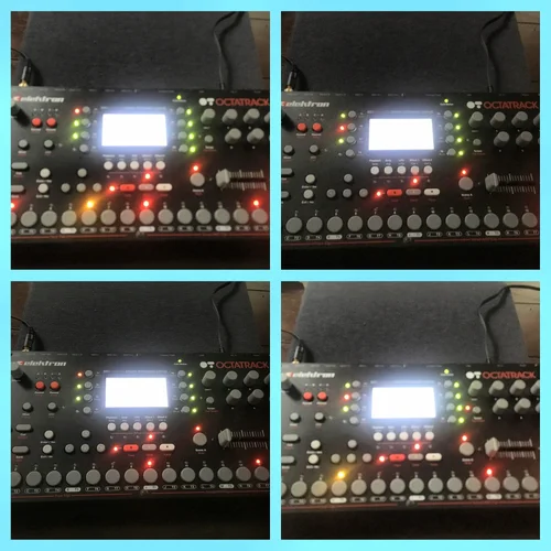

moin, wie aktiviert man den ‘fill mode‘ ??
aus dem update readme :
  • FILL is true when the sequencer is in fill mode. Fill mode is activated for one pattern iteration by pressing [DOWN] + [PAGE]. It will activate when the pattern loops and remain active until it loops again. It is also possible to momentarily activate fill mode by pressing [UP] + [PAGE]. The fill mode will then be active for as long as [PAGE] is being held down. To latch the fill mode, press [UP] + [DOWN] + [PAGE]. The fill mode will remain active until you press and release [UP] + [PAGE].
bild oben links
track 1 latch fill mode
triggs sichtbar
bild oben rechts
track 2 latch fill mode
triggs nicht sichtbar
die beiden unteren bilder
normal rec mode
