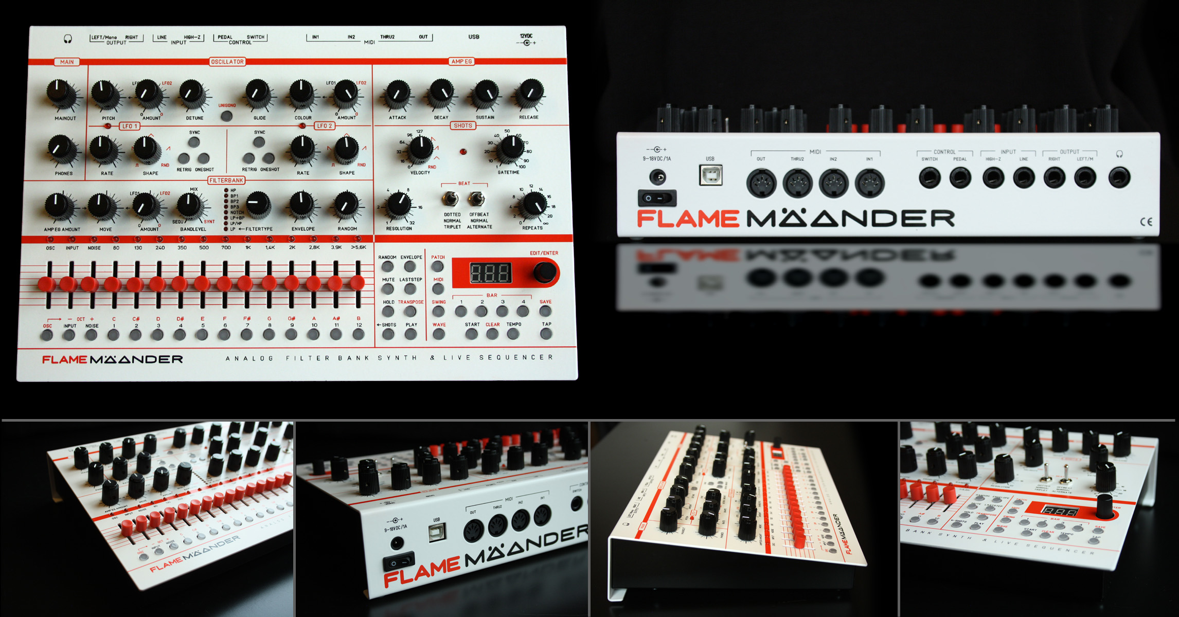

SHORT OVERVIEW
- 4 voice OSC wavetable oscillator (4VOX compatible)
- 39 wavetable memories (also for user defined wavetables)
- ADSR amplifier envelope, also usable as a filter envelope
- UNISONO mode for fat chorus-like sounds
- OSC has its own 4 voice polyphonic sequencer track for notes and chords
- analoge white noise channel, VCA controlled by own sequencer track and envelope (AR types)
- external monophon audio input with two separate input jacks (LINE level and Guitar level)
- audio input channel, VCA controlled by own sequencer track and envelope (AR types)
- analog 12 channel filter bank, 11x band pass, 1x high pass, each 24dB with some resonance
- filter bank is controllable via 12 VCA (8 filter typs and/or via 12 sequence tracks)
- filter types: LP, 3x BP, HP, NOTCH, combinations: LP/HP, LP+BP
- each filter channel is VCA controlled by own sequencer track and envelope (AR types)
- there are a mixer pot between filter bank sequencer and osc filter envelope
- modulations via 2 LFOs
- LFO waveforms are faded over softly (morphings)
- LFO sync with MIDI clock
- LFO retrigger and one shot mode
- LFO amount to PITCH, COLOUR (Wavetable), CUTOFF, Filter AMP EG
- LFO1 and LFO2 can be mixed with the amount control pots
SEQUENCER:
- Live note repeat sequencer with 15 tracks and pattern up to 4 bars
- one 4 voice polyphonic sequencer track for notes and chords (for the internal wavetable osc)
- 14 monophonic tracks for: 1x external audio input, 1x internal white noise, 12x filter channels
- SHOT section for live play back (note repeat functions)
- each channel with Laststep, Mute and Hold function
- each channel with individual envelope
- individual random function
- global swing function
- all pot positions automatically storable in Patches
- arpeggiator and scaler functions
MIDI:
- all sequencer tracks send and receive notes (via two different midi channels between osc track and other tracks)
- syncronisation via MIDI START/STOP/CLOCK, external clock is detected automatically
- both MIDI inputs are identical and are merged internally
- MIDI Input 2 also has a THRU socket (there the data arriving via MIDI 2 are forwarded)
- via USB you can connect to a computer directly with a MIDI connection
- Firmware updates can be downloaded via sysexfile via USB-MIDI
TECHNICAL DETAILS
HARDWARE:
- robust metal case
- size: 300x195x30(60)mm, weight: ca.2,5kg
- 15 analog sliders (analog channel attenuators)
- 25 Alps pots (for digital values)
- 2 Alps stereo pots (for MAIN out and PHONES)
- 43 illuminated pushbuttons
- 3 digit numeric display
- data entry knob
CONNECTIONS:
- Audio input channel with two separate input jacks (LINE level and Guitar level)
- Audio outputs left/mono, right (odd/even filterbank channels)
- Expression pedal input (stereo jack)
- Foot pedal input (stereo jack for two foot pedals)
- 2x MIDI INPUT
- 1x MIDI THRU from MIDI INPUT 2
- 1x MIDI OUTPUT
- 1x USB (for MIDI and firmware updates)
- 1x external power supply adapter +12v/1A​

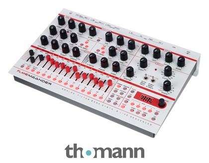

Was vielleicht nicht jedem ersichtlich ist: Das Ding hat auch Sound Presets!
Hab außerdem mit dem Entwickler gequatscht und er baut ggf. auch Parameter-Pickup ein.
Hier kann man z.B. kaufen:
