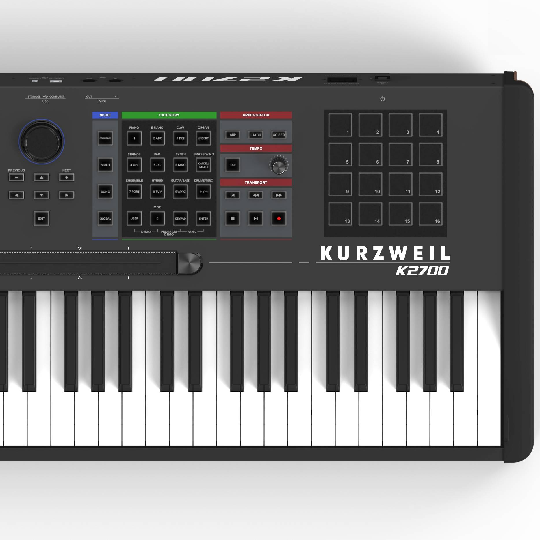

Folgende Eckdaten wurden auf gearslutz.com gepostet:
• FlashPlay technology utilizing 4.5GB of instrument Samples including:
• Optimized Unlooped German D and Japanese C7 Pianos, Triple Strike Piano, Classic Tine (73 & 77) and Reed Electric Pianos, Clavinets, Harpsichords, Celeste, Bells, Glockenspiel, Chimes, Bowed and Hit Crotales, Vector Synthesis Waveforms
• Updated Rock, Synth and Orchestral sounds from Kurzweil’s SP6, PC3/4, and KORE64
• 13 Categories of Programs (Piano, E. Piano, Clav, Organ, Strings, Pad, Synth, Brass/Wind, Ensemble, Hybrid, Guitar/Bass, Drum/Perc, Misc)
• 3.5GB of user Sample memory for loading audio Samples from WAV, AIF, and Kurzweil files
• KB3 ToneReal TM organ simulations with 9 sliders as drawbars
• FM: Classic 6 operator FM synthesis
• KSR: Kurzweil String Resonance (piano string resonance simulation)
• Half-Damper pedal support (for piano “half pedaling” sustain techniques)
• Kurzweil’s highly acclaimed VAST Synthesis and FX engine
• More than 1500 Factory Programs divided into 13 Categories
• More than 700 Factory Multis
• More than 4000 User IDs to save your own Programs and Multis
• Audio input jacks with FX (stereo pair accepting line/instrument/mic from 1/4” & XLR cables)
• Audio over USB (stereo in/out)
• 256 voices of polyphony
• 16 Zone MIDI controller in Multi Mode for Splits and Layers
• 16 MIDI Tracks in Song Mode
• Arpeggiator with dedicated front panel controls (up to 16 simultaneous in Multi Mode)
• CC Sequencer with dedicated front panel control (up to 16 simultaneous in Multi Mode)

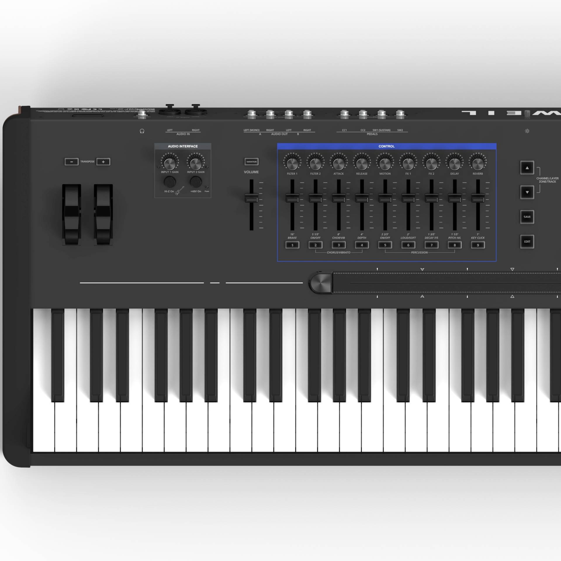

• 9 assignable sliders
• 9 assignable knobs
• 10 assignable buttons
• 16 assignable velocity sensitive pads
• Pitch Wheel and assignable Modulation Wheel
• Tap tempo button and tempo knob
• 2 Transpose buttons
• Monopressure (Aftertouch)
• Assignable ribbon controller

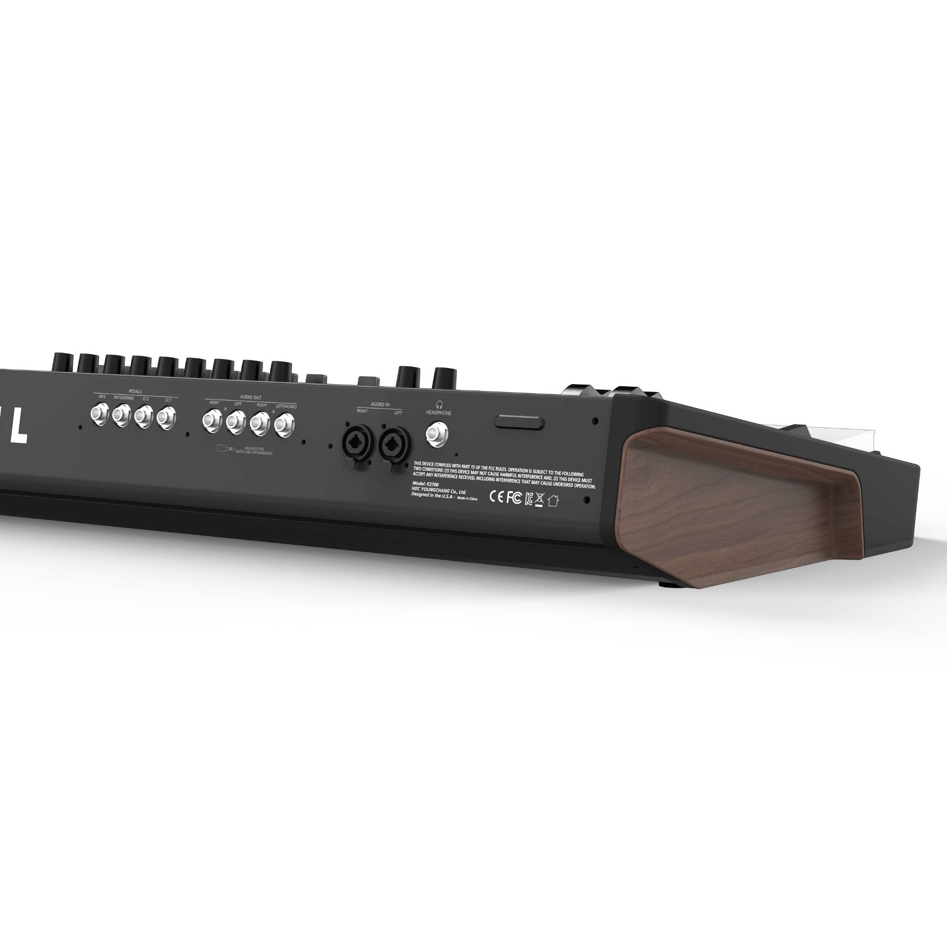

• 2 assignable switch pedal jacks (supports up to 4 switch pedals with 2 pedals per jack)
• 2 assignable CC pedal jacks
Fatar TP/40L with pressure. 88-key, fully-weighted hammer-action with velocity and pressure (After Touch) sensitive adjustable keys.
480 x 272 pixel high resolution color LCD with adjustable brightness 256 voice polyphony, dynamically allocated
16 parts (one per MIDI channel)
5.5” (13.97 cm)
15.5” (39.37 cm)
51” (129.54 cm)
52 lb (23.58 kg) Internal power supply

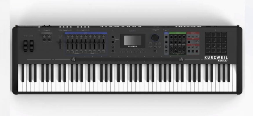

warum man heute bei so einem Flagschiff keinen großen Touchscreen einbaut, ist mir ein Rätsel.

Der hat weniger Pedalanschlüsse als ein PC3? Flaggschiff was?
Ich seh da vier Anschlüsse. Oder ist das Doppelklinke?
Die Switches können jeweils 1x Halbpedal oder 2x normales Switch Pedal.
Mich konnte bis dato noch kein Touch Screen in einem Keyboard überzeugen. Ich bin am Forte verdammt schnell mit den Soft Buttons. Ein wirklich guter Screen, wie in einem Handy, ist halt eine Kostenfrage.
M.i.a.u.: eisblau
Yamaha könnte, der Screen in den Clavinova CVPs ist auch dank Menüführung recht nahe da dran, aber die haben natürlich erst mal Murks in den Montage verbaut.
Mein PC3x lässt sich besser bedienen als viele der Touchscreen Flaggschiffe. Wenn diese Bedienungsqualität beigehalten wurde, dann kann ich gut damit leben!
