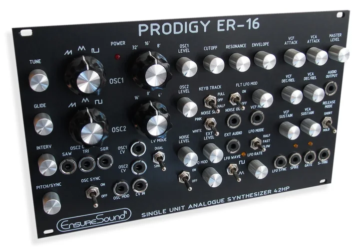

News!!!
New clone Prodigy ER-16, modified classic Moog PRODIGY:
Prodigy ER-16 EURO RACK 42HP
https://www.facebook.com/EnsureSound/
Technical specification same as MOOG PRODIGY...
Modification:
- dual CV for OSC1 and OSC2
- noise generator (white, pink) with noise level control and output
- dual LFO MOD for Filter and OSCs
- LFO synchronization input (any clock source 5V from sequencer, generator, etc. )
- external audio input
- OSC2 outputs (SAW, TRI, SQR)
- GATE, SPIKE, S-TRIG inputs
- DOEPFER power connector
- LFO, GATE, POWER LEDs
- OSC, VCF modulation inputs
I invite you to visit my page on facebook for details.
Soon available for sale on Ebay...
Best regards,
Ensure Sound
