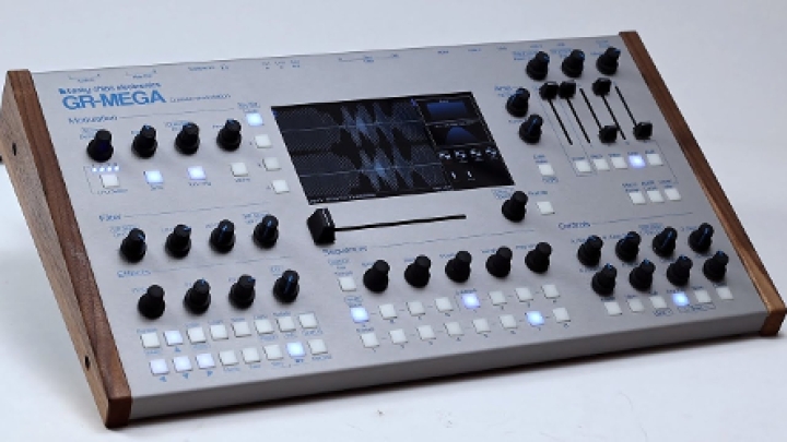

Tasty Chips GR-Mega Granular Sampler
Am vergangenen Wochenende auf der Superbooth erstmals präsentiert, hier jetzt auch Zahlen und Fakten von der Tasty Chips website:
FeatureSpecRemark
General
Multitimbrality4 layers
Polyphony per layer20 voices
Total number of grains5000all layers combined, about 4 times as much as the gr-1
EnginesSampler(including loop, start end)
Granular
Tape mode
Granular slice modeSampler slice mode possible
Spectral
Preset system
Number of presets128per project
Multitimbral combinations1000per project
Number of projects50
Sampling and samples
Audio input2 channels (stereo)
Max sample length60 minutes3 minutes max in granular, because of polyphony
Sample rate48 kHz
Mix resolution32 floating point
Sample channelsmono or stereo
Granular engine
Max chord size12
Max grains per voice128
Rate modesFree, Sync-size, Scan & rateFree means independent rate and grain size, other modes have synchronized rate and size options
Loop modesBounce, wrap, kill
Arp modesUp, down, random, shuffle, play order, and more
Spawn modesDirect, gradual, recycle
Phase vocoder
Max polyphony3
FFT size256..8192
Chord modeup to 12 notes per voice
Mod matrix
Number of LFOs44 per layer
Number of modulation sources20
Number of modulation destinations80and growing
Number of step sequencer modulators4
Filters
Filters per voiceLPF and HPF
Slope12 dB per octaveOther slopes possible in future firmware
Envelopes
DestinationsPitch
Filter
Amplitude
AuxFreely assignable
Length0.1 ms .. 45 s per stage
StagesADSR
ShapeCurved: from log to linear to exponential
FX
Number of simultaneous fx4
EffectsDelaysPlain, and ping pong
ReverbsHall and large (algorithmic)
DistortionOverdrive, and reducer
Dynamics (compressor)
More effects possible in future firmware
Step sequencer
Max chord size7
Max steps64
Step sequencers per patch1In multitimbral mode you’ll get up to 4 step sequencers total
Connectivity
Audio outputStereo TRS 1/4 ” balanced
Audio inputStereo TRS 1/4 ” balanced
SNR110 dB (in and out)
Headphone1/8 “
MIDIDIN (in out thru), USB C (in and out)
Eurorack interface1x gate out, 2x CV in (-5V..+5V)
LAN (ethernet)Gigabit (firmware update & filesharing)
Disk / USB sticksUSB A 3.0
Computer keyboardUSB A 2.0
HDMI output (monitor or beamer)1.2 full size
Storage
Included USB stick32GB, USB3, up to 100 MB/s
Internal storage512GB, 200+ MB/s
Dimensions465x270x95mm WxDxH
Weight4 kg
Zusätzliche bisher bekannte Infos:
Voraussichtlich gegen Ende des Jahres erhältlich, anvisierter Preis: ~1.800€
Für Besitzer des "kleinen Bruders" GR-1 interessant: die Software wurde von grundauf neu geschrieben, es dürfte also fraglich sein, was davon auch den Weg in den GR-1 findet (von den Beschränkungen der Hardware mal ganz abgesehen).
Einen direkten Vergleich von GR-Mega und GR-1 gibt es ebenfalls auf der Website.

Audio In, Midi In/Out/Thru - endlich. Ob mir das aber den saftigen Preis wert ist, muss man sehen. Oder besser hören. Bei den Effekten und bei den Filtern besteht erheblich Potential für Verbesserungen.
Weiss das jemand, ist beim Neue die Abspielposition nun endlich polyphon?
Ich hab direkt mal geordert. Hab voll Bock auf das Teil. Finde den Preis im Rahmen des Gebotenen in Ordnung und hoffe, dass die Firmware stabil läuft.
Bisher habe ich von der Soundqualität her und mit diesem Direktzugriff noch nichts Besseres im Granularbereich unter den Fingern gehabt als den GR1. Der hier reizt mich schon wegen der erweiterten Möglichkeiten und die Demos lassen Gutes erahnen.

Ich bin zwar kein Mitglied des hohen Rates, aber die für mich wichtigsten Unterschiede sind die MIDI- und Audioschnittstellen sowie die Bedienung. Der Workflow wirkt auf mich übersichtlicher. Auch die Presetverwaltung scheint mir besser gelöst zu sein.
Beim Sound bin ich zurückhaltend. Keine Ahnung ob das nun besser oder anders als der GR1 klingt. Das kommt auch stark auf das Ausgangsmaterial an. Beim GR1 finde ich Filter und Effekte verbesserungsbedürftig. Davon höre ich in dem Video oben aber zu wenig, um das zu beurteilen. Spannend finde ich die Spectral-Abteilung und den Step-Sequenzer.
Die Unterschiede zum GR-1 sind nett. Die bessere Presetverwaltung sollte der GR-1 laut Tasty Chips mittlerweile auch haben. Die Filter sind in beiden Geräten die gleichen (SVF), im GR-1 als ein Multimodefilter, im GR-Mega als ein Low- und ein Highpass. Den internen Sampler bräuchte ich nicht, da ich sowieso mit Software sample, weil ich meine Samples ggf. auf verschiedene Arten nutzen will. Ein guter Field-Recorder kommt mir aber auch noch ins Haus. Die zusätzlichen Engines finde ich weniger interessant, wenn ich granular kaufe, will ich auch granular und möglichst nichts anderes (außer subtraktiv natürlich). Ich würde wahrscheinlich zum GR-1 greifen.
M.i.a.u.: easyboy und HairyHands
Da habe ich noch keinen Vergleich, da das erst mit Firmware 3.0 kommen soll. Laut dem Video zu GR-1 3.0 finde ich es im GR-Mega trotzdem einfacher.
Die extra Schnittstellen wird nicht jeder benötigen, das stimmt. Für mich sind sie sehr praktisch, da ich den GR-1 sehr gerne als Echtzeit-Effekt einsetze.
Der GR-Mega wird mir einiges an Verkabelei und Zubehör ersparen.
