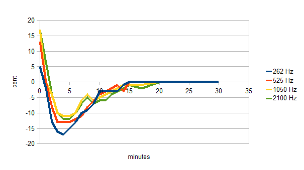

Temperature stability
For additional temperature compensation the VCO uses a 1 kohm temperature compensation resistor. The ideal temperature coefficient for this resistor is supposed to be 3300 ppm. I used one with 3000 ppm temperature coefficient. This VCO uses the Bergfotron standard socket for the exponential converter transistor pair and temperature compensation resistor. Here you plug in a component carrier where you solder the transistor pair and tempco resistor of your choice. These should be in thermal contact and preferably potted together for lowest temperature drift. I used surface mount parts (dual transistor + tempco resistor) soldered to a small circuit board on the component carrier which plugs into the 8 pin IC socket. The parts were potted with Araldite. If you don't use surface mount parts, you can solder the dual transistor and tempco resistor directly on the circuit board. For practical reasons I recommend the solution with the component carrier even for these though.
