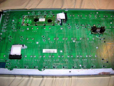

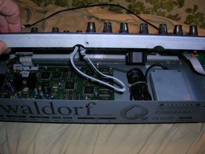

I have a Waldorf Q rack that has a "shift" button that does not work well so it may need to be replaced. I have removed the 20+ screws that hold the board supporting the faceplate but the faceplate still will not separate from the circuit board underneath it.
Thanks if you can help me with a photo of the top of the rack with the front plate removed. Or a referral to another person or forum to ask. It is a great sounding synth. But it requires holding down both the "shift" button and the "sound" buton to store any patch changes I want to save. The bad "shift" button makes it difficult to store any changes to the current program.

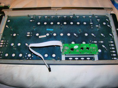

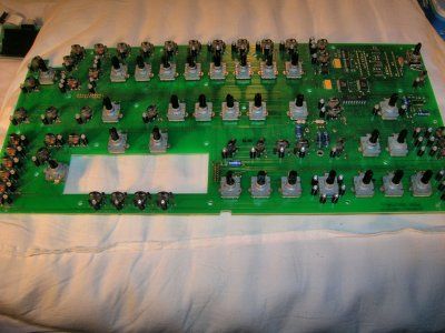

OK - I got the Waldorf Q rack faceplate separated from the controller board. It turns out that one of the screws that I needed to remove was partially covered with hot glue so I did not see it.
Here are a couple photos showing the interior controller circuit board, and faceplate of the Waldorf Q Rack. The Waldorf Q Rack opens by removing most of the screws and lifting the back of the front panel. To separate the faceplate from the controller circuit board be very careful to remove all the screws holding the board in place. One screw might be hidden by hot glue so check that. If you got all the screws out, the circuit board will separate easily. I do not think you have to remove the card slot but if you do, it is held in place with two screws.
