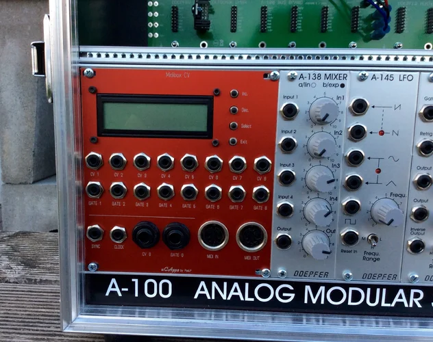

verkaufe mein ucapps midibox cv interface fürs eurorack ( doepfer )
hier die specs :
up to 8 CV outputs with 12 bit resolution
8 gate outputs
Outputs can be assigned to 16 MIDI Channels and Note/Velocity/Aftertouch/CC/NRPN/Pitchbender events
8 independent Note stacks with 16 notes depth!
Mono/Legato/8*Poly mode
selectable Pitchbender range
Octave and Semitones Transpose function
Keyboard Split/Layer function
Selectable Gate Polarity
Selectable Output Curve: V/Oct, Hz/V, Inverted, Exponential
Interpolation function (smoother) with selectable slew rate from (1mS..64mS)
DIN Sync Output (StartStop and Clock) with various dividers and multipliers (96ppqn .. 24ppqn / 16)
Easy to use Calibration Function
MIDI Merger (MIDIbox Link compatible)
support for BankStick, stores 128 patches
configuration via 4 buttons/LCD or via SysEx
damit kannst du ne menge machen...mehr geht nicht für das geld.
preis ist 200,- euro
