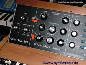

it introduced the mod and pitch wheel, 2 envelopes, 3 VCOs, where VCO3 can also act as LFO (well, every VCO can be an lfo if switched to low..) and this philosophy has been a good one: no extra LFOs, there ARE VCOs!!.. ok, the voyager adds an lfo, now because todays synth need more than 3 VCOs/LFOs.. but the principle was the only one that wasn’t taken over by other synth manufacturers. but the macbeth m3x, the ems vcs3 arp 2600 had a similar way of thinking..
OSCs, Noise 2 very fast envelopes (about 1.5ms)

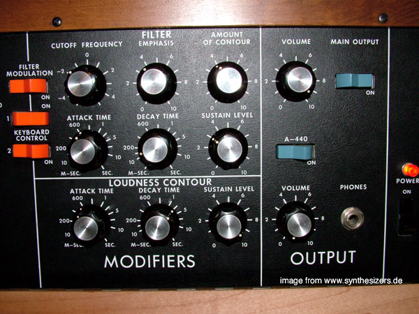

the mini has a special envelope: it holds at attack runthrough for s while and then goes down, but with a big zapp.. means: it is fast and musically well. thats a thing the others or emulations and clones do not have (so far)

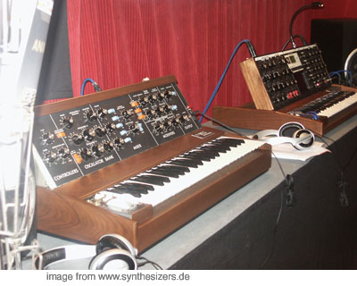

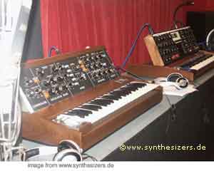

the legendary – MINIMOOG and V’GER side by side!!

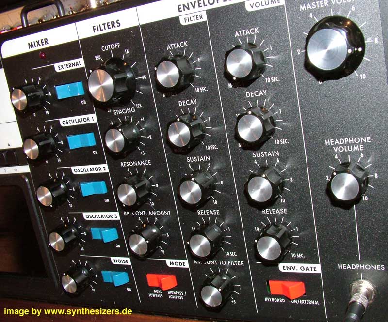

MOOG Voyager UPDATE (current is 1.5, now 2.0):
even more control now, more mod routes to the pad and lots of updates in the software!!
1.5 deutsch:
Laden & Senden von einzelnen Presets möglich
– save&send patches via midi
Filter A/B lassen sich von 1-4 Pol umschalten.
– you can switch the filters from 1 to 4 poles (6dB to 24dB/oct)
Mehr Modulationsmöglichkeiten für das Touchpad
– more mod source for touchpad
Midi Local Off, Merge und PGm Change now implemented..

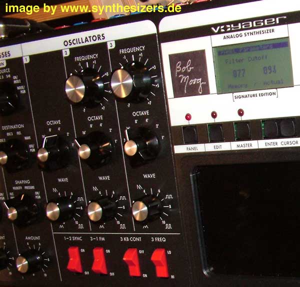

<– new at moog music: minimoog V’ger.. rudi linhard does the midiimplementation.. the first signature series has been sold and should show up by end of 2002. there are some chances planned: HPF (previously missing) will replace the 2/4 pole switch. and lots more..
it’s sound is indeed high quality, but it’s price is „fan only“.. rudi linhard, who does the midi implementation (well, he just got his first voyager in summer 2002 – so all will be ready later.. the „people“ say, that it might need a hardware mod. so maybe all will be delayed..
one of the first Voyager owners‘ report (warning: strong affective binding to the product) here (at mark pulvers midiwall)
there is the so called spacing filter so you can have lots of interesting filter sounds with the 904 filters from the modular (like the andromedas 904 filters, but maybe better)..
software: is very preliminary: the touchpad is hardwired to cut,resonance and spacing, and lots of thinbgs that come in later.. (mod definitions, velo curves..)
but the OS is updateable via MIDI.
the newly implanted hpf was a bit „unpredictable“.. so the first batch is out with RUDImentary software (this one goes to rudi linhard, who does the software part)
you find some first sounds that really show even through mp3 that this machine simply sounds GREAT ;) (I can confirm this, listened to one / the original.. )
a good idea: the control of it all: you can integrate this nicely into modular environment..
btw: you got a LPF and a HPF that can be separated by the spacing (range is 6 octaves between the setting of cut and spacing)
also you can have another LPF at 24dB/oct
so this makes hpf,bpf,lpf or better: pan lpf (you got 2 VCAs) so its parallel, the bpf is of course done by serial filters
thanks to mark for info. just rewrote it combined it with my info ;)
btw: the voyager uses 14bits for controllers! so it is like on the alesis andromeda: 16384 steps per controller,so in fact it feels like a seamless analogue knob!! but the computer will have to be smart! it’s much more to send/receive now!
50hz lfo, 2 filters with spacing (so it is a cutoff offset), 2 envelopes

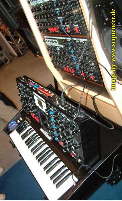

MOOG RME (voyager: rack mount unit) find pics on the moog site
there is a 5U Voyager RACK VERSION AVAILABLE (called the RME), too .. chain them together for polyphony for a rather expensive poly moog rack .. hmm 15spaces high for 3 voices.. but very high quality.. still.. ok, it basically the same as the v’ger but it has no touch pad and no keyboard of course.. us: $2195, in europe it might be much higher (deutscher distributor EMC) assume it is around 2200€. btw: the RME hasn’t the full input connectors as the key version has! so you need another VX351 box version to get them all out to another breakout box.. important for modular users!

mini moog and voyager side by side

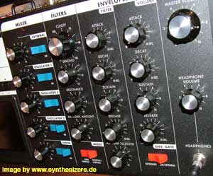

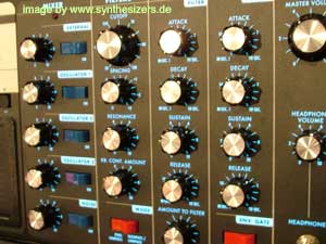

control panel moog voyager
Voyager control panel – click to enlarge..
