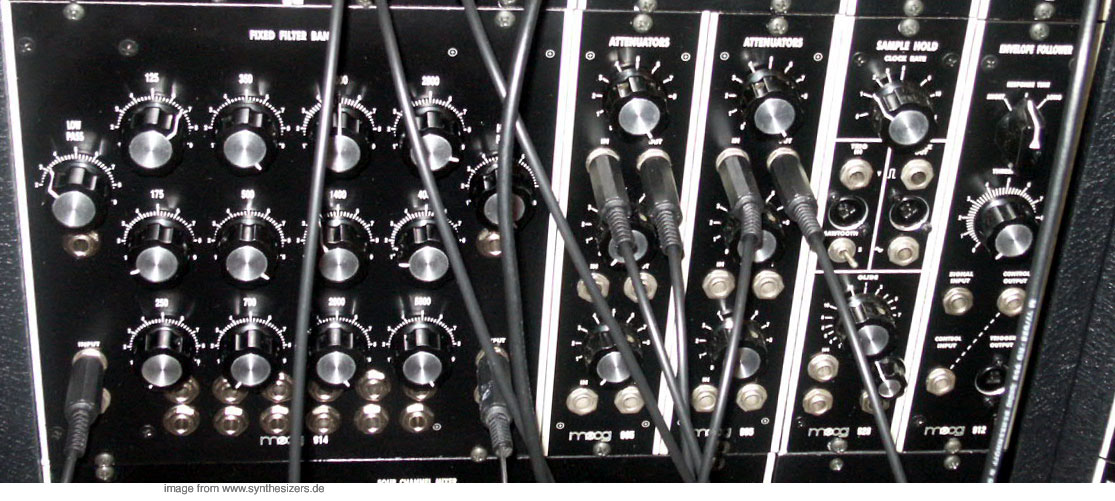

fixed filter bank, 914 modified with ind. outs for every single freq-band. THIS is imo one of the nicest sounding modules.. there are not many standalone fixed filter banks out there (exept the one from snd) , attenuators (you need those to set the real mod amount to any mod destination) 995, Sample and Hold/gilde 928, envelope follower 912

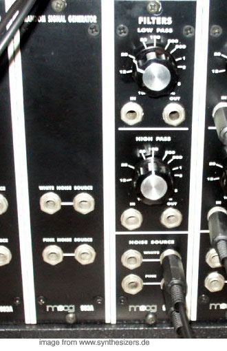

this is pink and white noise 903A, but with the 923 you have a LPF and HPF that cannot be modulated or voltage controlled
but it’s nice to have specially filtered noise sections or pre-filter some VCOs.. if you turn it: it really sounds good!!.. so this is a good thing if you want to save CV-able filters.. or the fixed filter bank

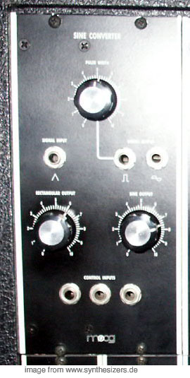

this can be used to reconvert sine waves into rectangular or saw!! turning the know gives interesting effects on the „edge“, modable! gives some intersting bite!! well, moog themselves did not do this module, so I don’t know really who did the ciruitry, but if you come across one just think if you need those „shaping“ kind of convertor or not but don’t think of selling it as a moog. as well as most of those modules shown here, they are here to show how they look like / the tech / function, but imagine them with different metal sides, then ;)
