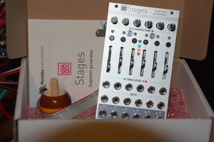

von der produktseite:
The modulation construction set
ASR envelope, complex 6-stage envelope, LFO, 4-step sequence or switched LFO: Stages can be any kind of modulation.
Not because all these behaviors have been pre-programmed in the module, but because it allows you to describe your own modulations in terms of basic operations: ramp from one voltage to another, hold a voltage at a set level, wait for a trigger and slew. With or without looping.
Whether you need one complex envelope, or several simpler modulations, Stages reconfigures itself according to which of its gate inputs are patched. There is always a role for it in your patch.
That’s it
Really, there isn’t more to the story.
Self-generating chiptunes? Very weird LFO shapes? Random gate delay? Stages probably does strange and wonderful things when patched in a certain way.
Flexible input/output layout
The module detects the presence of jacks on its gate inputs to group its segments: whether it is configured as a complex 6-stage envelope, or 6 individual envelopes, or 3+3, 2+4… depends simply on how you patch it. Dummy patch cables might come handy!
When used as a multi-segment envelope, a segment activation signal is produced on all secondary outputs - for example to trigger an external event when an ADSR envelope enters its decay, sustain or release stages.
In case more than 6 segments are required, up to six modules can be chained together thanks to a connector at the back of the module.
Three segment types
  • Ramp segments go from one voltage to another, in a CV-controlled amount of time, with an adjustable curve (accelerating, uniform, decelerating). They are the building block used for the attack, decay or release segments in envelopes… or for LFOs.
  • Hold segments stay at a constant (but CV-controllable) voltage for a programmable amount of time. They serve as the sustain or hold segments in envelopes.
  • Step segments glide to a target (CV-controllable) voltage, then stay at this voltage for a certain amount of time until a trigger is received. They are the main ingredient for step sequences, but also for building sequential switches or a sample-and-hold.

tja, ist geschmackssache. ich persoenlich bin ehrlichgestanden nicht so richtig warm geworden damit und werde womoeglich schwach werden und mein vorserienmodell aus dem beta-test verkaufen, wenn das erste batch ausverkauft ist und mondpreise dafuer gezahlt werden. ;-)
nein im ernst, ich will das modul keineswegs bashen. es ist wirklich wahnwitzig vielseitig und flexibel, und entsprechend kreativ kann man es einsetzen. aber ein grundproblem ist fuer mich, dass die dreh- und schieberegler je nach einstellung und position des jeweiligen segments vollkommen unterschiedliche parameter steuern: zb die schieberegler mal zeit, mal amplitude.
das liegt am erbe der adsr-huellkurve, das olivier hier mitschleppt, wo das ja schon genauso ist. nur dass man sich bei adsr dran gewoehnt hat und den ueberblick nicht verliert, weil es ja immer gleich ist. aber hier kann man die segmente sehr flexibel immer neu kombinieren und muss dabei dann aber den ueberblick behalten, welcher schieberegler jetzt eine zeit, und welcher eine amplitude steuert etc.
mich persoenlich verwirrt sowas, andere finden es unproblematisch und haben viel spass mit dem modul. ist geschmacks- und sicher auch gewoehnungssache, muss man ausprobieren.

der wechsel zwischen amplitude- und zeit-zentrierten segmenten macht das modul auf jeden fall weniger simpel, als es bei einem ersten blick aufs panel vielleicht wirkt.
die einen werden die resultierenden flexibilitaet lieben, andere werden von der vielleicht unerwarteten komplexitaet genervt sein. wieder andere werden einfach den vollen funktionsumfang nicht ausreizen und es zum beispiel immer nur als huellkurve oder sequencer nutzen, und trotzdem gluecklich damit sein.
ich wuerde sagen: vor dem kauf das manual gut studieren und nach moeglichkeit das modul mal ganz in ruhe ausprobieren, um zu sehen, zu welcher fraktion man gehoert. bzw beim ausprobieren nach dem online-kauf unterlegscheiben verwenden, damit man es guten gewissens zurueckschicken kann, falls der funke nicht ueberspringt. ;)

stages funktioniert durchaus auch als audioquelle. im geloopten gruenen modus geht es bis in den audiobereich, und der 'time'-cv-eingang trackt v/oct. der 'shape'-drehregler bestimmt dann die wellenform. man kann das modul also zb auch als eine bank von 6 vco nutzen. :)

nur mit 1x stages und 1x ripples liesse sich so schon eine komplette synth-stimme basteln: ein segment von stages ist der vco, die uebrigen segmente konfiguriert man ganz nach laune als mehr oder weniger komplexe huellkurven und lfo fuer das filter und den vca von ripples...

das ist auf jeden fall gegeben. und da alles digital ist, trackt es auch sauber ueber viele oktaven, sodass man mit entsprechend hoher steuerspannung den fuer melodische anwendungen ueblichen vco-bereich wohl abdecken kann...
