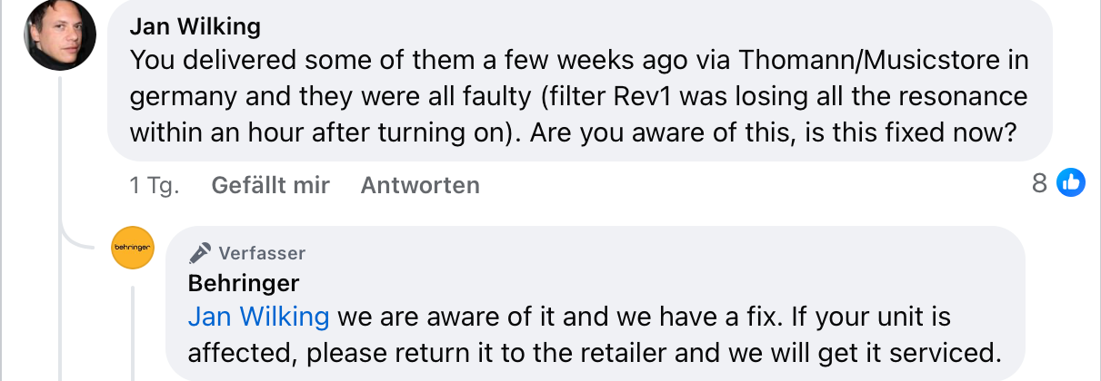

Jetzt ist es auch offiziell... auf Facebook:
Introducing the Behringer K2MKII: Analog Power Redefined!
We're thrilled to announce the launch of the K2MKII, now available at our super partners! This beast brings a dual VCO design for incredibly fat analog sound. With OSC Sync, FM, PWM, and V/Oct CV/Gate control, it's a dream for sound designers. Featuring authentic circuitry, 4 variable oscillator shapes, and a semi-modular layout for instant creativity—no patching needed! Ready to elevate your setup with those iconic high-pass/low-pass filters?
Get yours now and unlock true analog performance!

Für die Nicht-Facebooker, zumindest gibt Behringer den Fehler zu und hat angeblich einen Fix.
