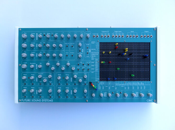

Cric is a fully-analogue patchable synthesiser, designed to showcase our approach and attitude towards subtractive sound synthesis. It is not a clone or derivative of a pre-existing musical instrument, nor is it simply our Eurorack modules cased up in a box. Whilst some of Cric’s functionality descends directly from our experience in designing modular synthesiser components, it has been designed as a fully fledged, standalone instrument, which can easily be introduced into an existing electronic music studio, or even form the heart of an entirely new set-up.
Rock solid voltage-controlled oscillators give the user both pitch precision and FM flexibility. A comprehensive filter section affords timbral sculpting from basic filtering to total transformation of incoming tones. Four cyclical function generators can be used as envelopes, LFOs or even audible VCOs. Pin matrix patching allows for the synthesiser to be configured as a standard triple-VCO subtractive synth, or a paraphonic synth, or a drum machine, or a noise box, and so the list goes on. Four inputs and outputs allow for audio processing, external CV control, feedback routing and more - there's even a microphone pre-amp on input 1. Steel casing, Mirrl-clad HIMACS end-cheeks and hand assembly and testing ensure a rugged and durable build quality.
RRP: £2,499.00Available 7th November 2024
Technical specifications:
Oscillators : Three SSI2131-based analogue VCOs in Recombination configuration, white noise generator
Filter : SSI2164-based 18dB/octave state-mixable analogue VCF, with wave-folding, based on the Timbral Sculptor
Dynamics : SSI2164-based VCAs present in DNA oscillators, filter section and as a standalone VCA
Modulation : Sample and hold + four cyclical function generators offering AD and ASD envelope configuation, cycle mode, and slope and pulse sources
Routing : 24 source x 32 destination active pin matrix allowing for splitting and summing of all signals

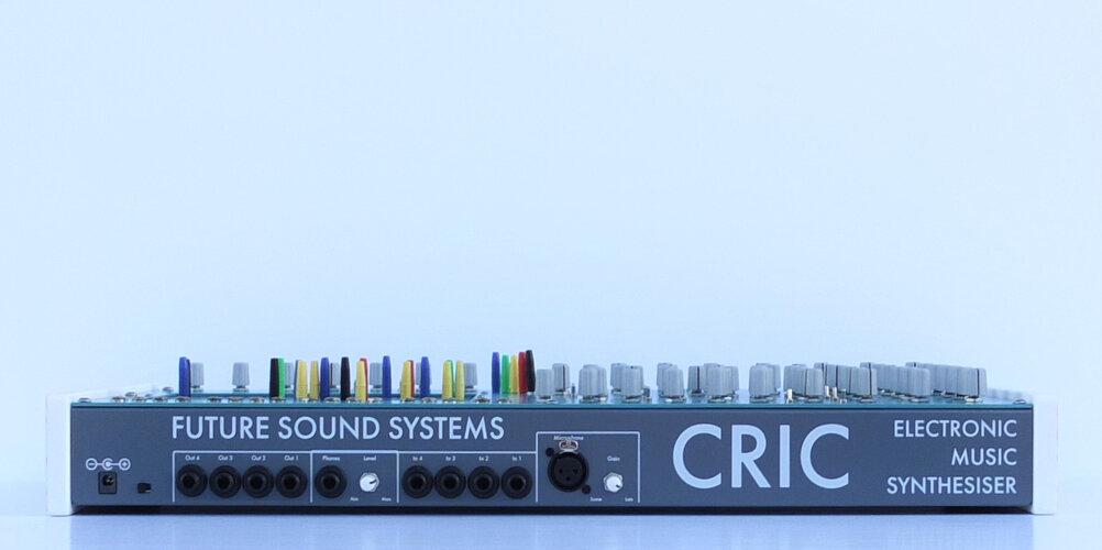

I/O : Four DC-coupled inputs and outputs for multi-channel audio and CV use. Microphone pre-amplifier assigned to In 1. Headphone amplifier on Out 1
Dimensions : 550 x 310 x 80 mm, 5.3 kg
Power : +12VDC (centre positive, 2.1mm barrel jack connector), 2.5A, PSU included

Schönes Teil, was mir so aufgefallen ist:
Pins sind wahrscheinlich sie so wie bei ihrer MTX Matrix ohne Widerstand.
Unterschied zu einem Eurorack Modular ist das hier die Ausgänge und Eingänge Abschwächer haben, Eurorack fast immer nur bei den Eingängen, EMS bei den Ausgängen. Ich mag den EMS Stil eigentlich bei einer Matrix.
Wahrscheinlich hat er auf beiden Seiten Abschwächer weil eben diese Matrix keine Widerstände bietet.
Kein Ringmodulator.
Einen zweiten freien VCA hätte ich noch Sinnvoll gefunden.
Die 4 externen Ins und Outs sind toll um Effekte einzuschleifen.
Auf ihrer Webseite hat es auch Audiodemos zum Synth.
Vermutlich. Ich habe deren MTX Pin Matrix für Eurorack... die Pins sehen exakt so aus, wie auf dem CRIC. Ich könnte aber auch mal Finlay anschreiben und nachhorchen... dann hätten wir Gewissheit.
Wegen mir nicht, aber erzähl, wie ist das Übersprechen bei der Matrix? Loopop hat die Matrix mal getestet und kein Übersprechen festgestellt.
Sitzen die Pins fest ohne Wackelkontakt?
Ich bin kein professioneller Tester geschweige denn Influenzer wie Loopop... ich kann aber bestätigen, dass ich bis dato kein Übersprechen wahrgenommen habe. Die Pins sind recht einfach gehalten (um nicht "billig" zu sagen) - sitzen aber fest in der Matrix, da wackelt nix. Klar ist aber auch: Wir sprechen hier nicht von Giehlmetti ;-)
Ich hatte mir seinerzeit noch ein Tütchen Ersatz-Pins bestellt - so kam auch eine ganz nette Kommunikation über E-Mail mit Finlay zustande, witziger Typ.

Der Cric müsste dann schon auch real für Tracks einsetzbar sein. Er hat ja z.B. kein MIDI. Das hätte mich früher schon total abgeschreckt. Da ich jetzt aber hauptsächlich mit dem Oxi One arbeite, sollte das doch auch über CV gut funktionieren. Ich habe KEINE wirkliche Modularerfahrung. Mache aber schon seit 39 Jahren elektronische Musik.

es gibt so viele Sequencer die CV/Gate IO bieten. So ein richtig erntes Problem ist das eigentlich nicht.
  • #29
Ja klar aber es wäre sicher komfortabler wenn er das Interface on board hätte damit man nicht immer diese Infrastruktur wo anders herholen muss.
ja auf jeden Fall... ich bin da ganz bei dir. Wegen mir darf jeder Synth ein ordentliches Midiinterface bieten. Aber wenn der Synth sonst supergeil ist, wäre es für mich kein komplettes Ausschlus-Kriterium.
  • #30
Ja das stimmt. Aber ich muss sagen das es mich bei dem Synth irgendwie stört weil man ihn nicht irgendwo hinstellen kann und dann doch dieses Kabelgewirr ran muss obwohl man die schöne Pin-Matrix hat. Ja, jammern auf hohem Niveau.
