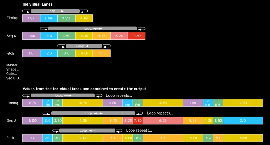

Dan Philips von Korg hat es so beschrieben:
The Wavestate is fundamentally a samples + subtractive synthesis architecture. Wave Sequences play lists of samples, and can also modify synthesis parameters, like a complex step sequencer. The primary point of interest is the way that Wave Sequencing 2.0 can manipulate the order, timing, and synthesis parameters associated with the samples in complex, non-repetitive, and modulatable ways, and the richness that this provides when combined with the samples themselves.
The modwave is primarily a wavetable synthesizer. (It can play samples too, but not wave sequences.) Its oscillators play single-cycle waveforms. These waveforms are grouped into sets called "wavetables," which let you smoothly transform from one single-cycle waveform to another. You can change these wavetables in various ways at load time (such as isolating odd or even harmonics, adding new harmonics through anti-aliased clipping and quantization, etc), and also manipulate the oscillators in realtime, with modulation, in some ways similar to analog oscillators (sync, several variations on pulse width modulation) and other ways which are digital-only (such as mirroring and flipping).
The modwave also has an advanced, per-voice step sequencer that leverages the discrete "lanes" concept of Wave Sequencing 2.0 for creating complex, non-repetitive patterns. Unlike Wave Sequencing, though, it doesn't trigger samples with sequencer steps. Kaoss Physics is really quite a different thing than any previous Kaoss Pad, btw - it's a game-like physics engine designed to be used as a modulation source.

List of modwave modulation destinations
Osc 1:
Position, B Offset, Xfade Width, A/B Blend, Morph Amount, Osc 1 LFO Intensity (to Morph), Osc 1 Env Intensity (to Position), Phase, Level, Pan, Octave, Tune, Transpose
Osc 2:
same as Osc 1
Sub Osc/Noise:
Octave (Sub Osc settings only), Level, Pan
Filter:
Cutoff, Resonance, Input Trim, Output Level, Filter Key Track Intensity, Filter LFO Intensity, Filter Env Intensity
(Technically, modulating the LFO, Env, or Key Track Intensities just creates a new mod routing to Cutoff, with the LFO, Env, or Key Track as the first source, and the new mod source as the intensity modulator)
Multi Filter adds:
Crossfade, Manual 1 LP, Manual 1 HP, Manual 1 BP, Manual 1 Dry, Manual 2 LP, Manual 2 HP, Manual 2 BP, Manual 2 Dry
Amp:
Level, Velocity Intensity, Amp Key Track Intensity, Amp LFO Intensity
(See above re LFO/Key Track Intensity modulation)
Pan:
Pan, Random Pan On/Off
Pitch:
Octave, Transpose, Tune, Slope, Portamento On/Off, Portamento Time, Pitch LFO Intensity
(See above re LFO/Env Intensity modulation)
Envelopes (x4):
Attack Time, Decay Time, Sustain Level, Release Time, Attack Curve, Decay Curve, Release Curve (also Trigger Source and Threshold)
Kaoss Physics:
Tilt X, Tilt Y, Friction, Time, Bump Height, Bump Position X, Bump Position Y, Edge Bounce Top, Edge Bounce Bottom, Edge Bounce Left, Edge Bounce Right
NB: Kaoss Physics can be modulated only from Channel or Performance sources, or from the Velocity/Release Velocity and Note Number of the most recent note (via a loophole in the system!).
LFOs (x5):
Waveform, Frequency (or Note Length and Multiplier, separately), Shape, Offset, Fade, Start Phase, Random Start Phase On/Off, Tempo Sync On/Off
Effects (x3 per Layer, plus Performance Reverb):
Edit 1, Edit 2, Edit 3, Wet/Dry
NB: Layer effects can be modulated only from Channel or Performance sources (see below). Reverb can be modulated only from Performance sources.
Arpeggiator:
Sort, Latch, Key Sync, Gate, Swing, Resolution
NB: The Arpeggiator can be modulated only from Channel or Performance sources.
Unison:
Number of Voices, Detune, Thickness, Stereo Spread
Lanes (x6):
Loop Start, Loop End, Loop # of Repeats, Note-On Advance On/Off
Timing Lane:
Speed (or Speed Ratio), Swing %, Swing Resolution
Individual Steps (64 per Lane)
Timing Lane Steps:
Probability, Duration Time (or Duration Note and Note Multiply)
Pitch Lane Steps:
Probability, Transpose, Tune
Shape Lane Steps:
Probability, Offset, Level, Start Phase
Seq Lane (A-D) Steps:
Probability, Value
Also - all Mod Knobs can be destinations (using Performance sources only), as well as sources. For example, you can modulate Mod Knob 2 from Kaoss Physics Distance.
* Per-voice, Channel, and Performance sources
Most modulation sources are per-voice, meaning that they have a separate value for every voice. These include ADSR Envelopes, LFOs, Mod Processors, Key Tracking, Seq Lanes A-D, Velocity, Note Number, Gate, Poly Aftertouch, etc.
Channel mod sources have a single value for all Layers on a given MIDI Channel. These include MIDI CCs, Channel Aftertouch, and Pitch Bend. The Pitch Wheel and Mod Wheel are also channel sources, operating on the Global MIDI Channel.
Performance mod sources have a single value for the entire Performance. These include the Mod Knobs and Kaoss Physics.
* Maximum number of modulation routings
The modwave creates modulation routings as required, as opposed to having a "mod matrix" with a fixed number of slots. Multiple modulation routings can be made to a single destination, and a single source can modulate any number of destinations. The only fixed numeric limit is that a maximum of 31 routings can be made to any single destination (!). On its sister instrument, the Wavestate, some Performances had ~200 mod routings.
