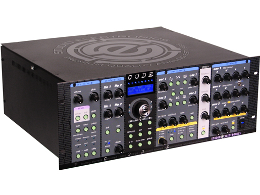

New Sinewave Generator features. Each voice now has a sinewave on oscillator 1 expanding the sound possibilities of the synth.
One of the key new features on the CODE is the Filter Control section, which allows you to sweep through all the filter types in real time with complete MIDI control. The switches in the Filter Control section give momentary control of assignable parameters.
The Filter Control Section allows you to:
• Sweep through all the filter types in real time.
• Increase or decrease the filter frequency.
• Increase the envelope amount.
• Increase the resonance amount.
• Filter ENV Delay.
• Invert the filter envelope.
• "CUT" Filter Decay.
• Works on the CODE synth engine or external input.

The new "OD" models give you classic analog amp overdrive for each voice.
The analog experts at Studio Electronics took their classic Omega Engine and couple of fresh ideas to come out with the NEW CODE Synthesizer. Two new great features on the CODE Synth are the sinewave generators and the new filter control section.
und insbesondere das

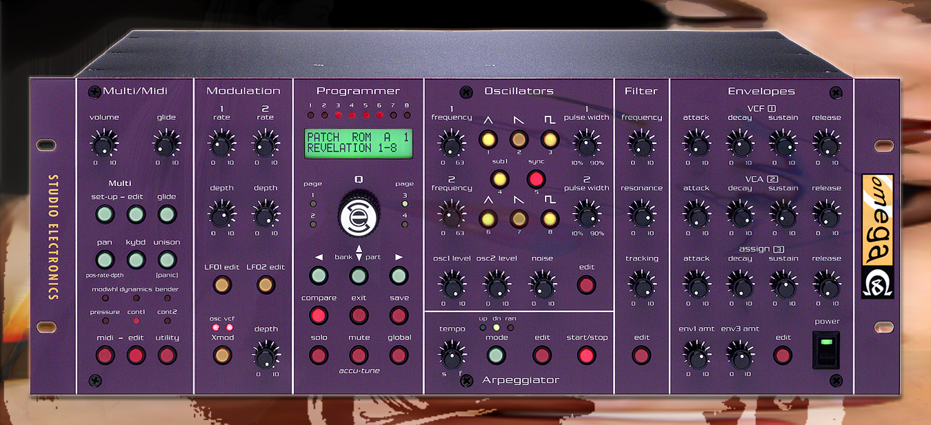

der alte hat ja nunal auch cut und res.. aber auch env amount als regler für env1 und env3..
den omega8 gibts auch als knopf mod

Und sonst entspricht der code dem omega 8?
und wann wird der kosten und kommen? Auf der homepage von se steht noch gar nichts von dem.
Also dann wäre das ein Super Omega 8.

Der O8 war da aber schon 8 stimmig.

Hab bei denen paar Sachen nachgefragt weil ich mich doch wirklich überlege mir so einen zu leisten. Hier ein paar Antworten auf meine fragen von Studio Electronics zu omega und code:
Does the code have faster env. than omega?
The Omega envelopes were spedup 2 years ago, they are very fast. We can essentially make them
insantaneous if we want to. When they get too fast they "pop" the VCA producing a transient noise that is not entirely desirable. We spent many hours testing and finally selecting the fastest attack time without the "popping" being too audible. They are somewhere between 1 and 1.5 milliseconds. They are also a true exponential response a perfect simulation of an analog envelope. We are very happy with their performance.
2. Are the envelops and lfo's digital ore analog?
Both are generated in software.
3.I made bad experinces with the digital env. and lfo's in analog synths. In the Andromeda you can hear the steps specifically when you modulate pitch.
There is no stepping when modualting pitch. The routines are 16 bit. Even at the slowest speeds the
modulation is perfectly smooth.
4. Is the fm in omega ore code linear and does the pitch don't get out of tune when you play fm on the keyboard?
We are doing audio frequency modulation. The audio frequency of Oscillator 2 can be assigned the modulate the cv of oscillator 1 or the cv of the filter resonance. Precision resistors are used, the tracking is as good as a discrete circuit will allow.
and maybe you can list me what exactly are the difference from omega to code. That would be very nice
You can compare the specs on our site with the Code at Nova Musik. But the main differences are
the added sine wave on Oscillator 1, the filter control section where you can sweep through the filter types and pushbutton control of the filter parameters, the option of an overdrive circuit on each voice, two new sound banks, and the enhanced graphics.
Greg
