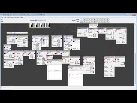

here’s what it does an looks like – the GUI – much like the Nord Modulars…

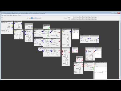

an older patch
ok – this is not part of the indiegogo thing.. but it may help to understand the „nord modular“ similarity – but this is not yet ready. this is sort of the control part and therefore referred to as „control“

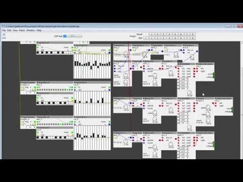

another demo and patch – which is quite easy to understand

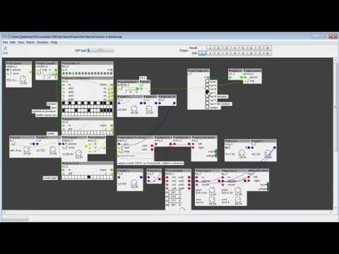

this one features samples – re-organising a breakbeat (I did this a lot on other systems so it is a good demo)
