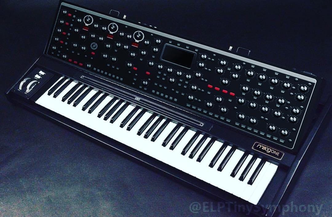

Moog One ist offenbar da – in den USA bei Sweetwater tauchte genau dieses Foto jetzt auf..
Preise: 8699€ – 16 stimmig und 8 Stimmen für 6690€
Zum Vergleich: Andromeda bei Einführung 4444€ / 8888 DM.

  • new 8/16 Voice Polyphonic Moog – popped up again on Sweetwater/USA – so this time it is for real. Memorymoog-Design:
it has in fact 4 Envelopes – one for Noise AMP Control – eine Hüllkurve ist für das farbige Rauschen zuständig und auch in der Modmatrix zu finden, die über 40 Einträge vertragen kann, vermutlich noch deutlich mehr, der LFO geht von 0,001Hz bis 1000 Hz..
alles ziemlich state-of-the-art.. – it’s all hi-end – the mod matrix has more than 40 slots with side channels/control and very flexible LFO speed – so this is a top notch synth – and sounds cool, those demos look as they should. Sorry guys – it’s a cool synth! it is! – the official one:

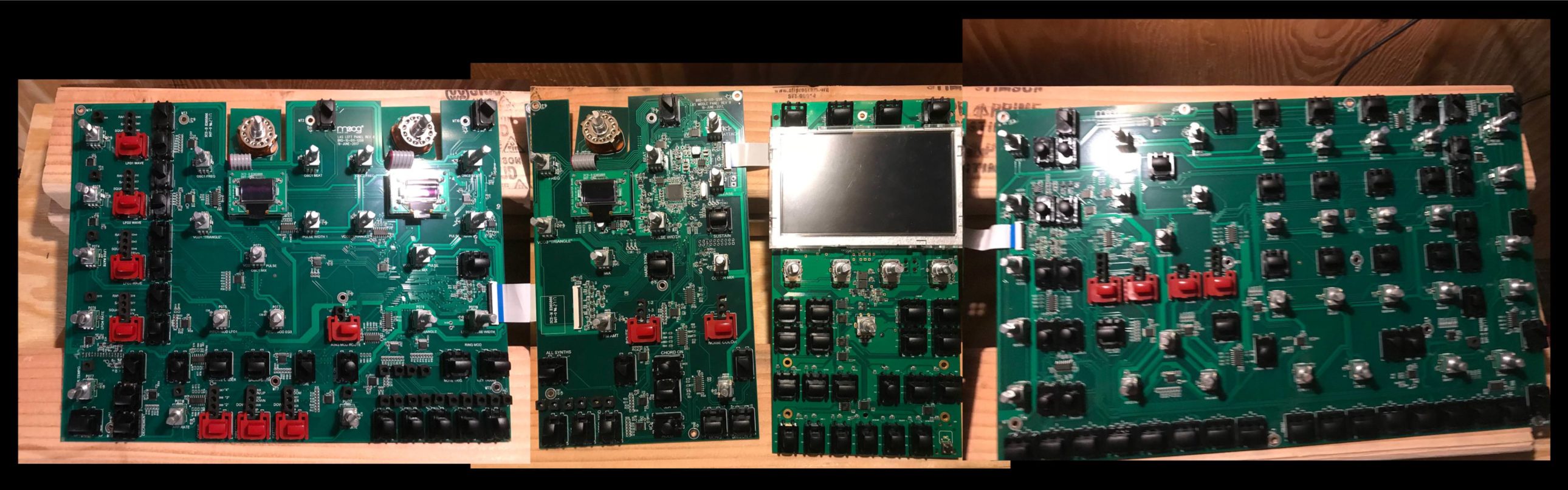

PCB / Platine
That new Moog One is announce to be in the shops in Mid August/September – there will be „tribute“ kind of first more expensive ones in the beginning and 3 VCOs in 3 multimode slots with lots of voices but at a higher price range is said by someone who seems to work at a shop or something. it’s not the first rumour – but the first much more „real“ one. that „one“ name was registered already in 2017, so it’s just a guess. here’s the specs:
  • 3 Oscillators (with waveshape mixing and OLED displays, VCOs)
  • Unison Mode 48 OSCS max @ 16 voices
  • 4 LFOs
  • 3 Envelopes DAHDSR,  user-definable curves
  • Extra Transient Envelope for Noises – maybe misunderstood Aux Envelope that controls „something“ – but listed under „noise“ and controlling „transient shaping“
  • Eventide Reverb, Vocoder
  • 3x Multitimbral – 1 FX per Slot, 1 Master FX
  • 2 Multimode Filter  4 types that function as a single filter
  • Ladder Filter – Moog Type, LPF/HPF
  • Modulation Matrix
  • Macro Controls for Performance
  • 2D Controller – maybe to be something like Animoog / Complex Waves / Vector / Wavetable Switch…
  • 3x Arper / Sequencer (per Multi/Timbre)
  • CV /Gate with free in/out routing
  • unreal number of memory
  • 1 button assign for LFOs
  • tune & complex mod movements via „transforms“ (whatever that means)
  • repeatable or simplified mod matrix input or something that makes „things“ easier in routing itvery Andromeda’ish, a bit of a Memorymoog plus Animoog –
  • $6k – 8 Voice, $8k 16 Voice Model
  • #Forum Page 170 <– src – here’s more – hier mehr lesen und diskutieren
  • Chord memory
  • Dual-source noise generator with dedicated envelope
  • Mixer with external audio input
  • Ring modulation, selectable routing
  • Oscillator FM, hard sync, selectable routing
  • Premium 61-note Fatar TP-8S keybed with velocity and aftertouch
  • Assignable pressure-sensitive X/Y pad
  • Digital Effects (Synth and Master Bus)
  • Eventide reverbs
  • Selectable glide types
  • USB and DIN MIDI
  • Save, categorize, and recall tens of thousands of presets
  • Create Performance Sets that make up to 64 presets accessible at the push of a button
  • 2 x ¼“ stereo headphone outputs
  • 2 pairs of assignable ¼“ outputs (supports TRS and TS)
  • 4 x ¼“ hardware inserts (TRS)
  • 1 x ¼“ external audio input (line-level)
  • 1 XLR + ¼“ TRS combo external audio input with trim knob
  • 9 assignable CV/GATE I/O (5-in/4-out)
  • USB drive support for system and preset backup
  • LAN port for future expansion
