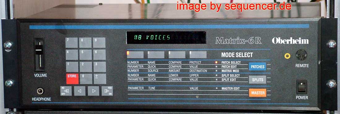

OBERHEIM Matrix 6 & Matrix 6R alternativen zum Oberheim Xpander / Matrix12 gibt es klanglich und finanziell:.. matrix 6 familie und marion systems (tom oberheims firma, mittlerweile auch pleite.. weiter unten..)
als erstes natürlich die Geräte der Matrix 6 „Familie“, also der Rackversion (3HE) also der Matrix 6R und die in schwarz und weiss daherkommenden Matrix1000.
2 DCOs, hard und softsync.
3 ENVs
1 tracking gen
2 ramps ,also superminihullkurven (steigend)
2 LFOs + globaler VibLFO
1 VCF 24dB/okt LPF
modulationsmatrix mit freier verschaltung (10 slots)
FM!
-üblicherweise nimmt man env1 f. pitch,env2 VCA,env3 FM amt

Matrix 6 / 6R— a cheaper alternative to the oberheim Xpander / Matrix12
3 ENVs
1 tracking gen
1 VCF 24dB/okt LPF
FM!

the matrix 6 and 6R are basically the same than the matrix 1000: xept:
1)matrix 1000 is 1 rack space high (matrix6r is 3 spaces high)
2) Matrix 6 and 6R can be edited on the box, the matrix 1000 NEEDS to be edited via computer only (like emagic sounddiver)
3) Matrix 6 has split mode and multi sets, so you got 2 different sound at the same time. the m1000 is poly only.
4) both can be edited using the access programmer (only used!)
the matrix’s got midi mono mode, means: you got 6 monophonic but independet midi channels.. like the casio cz series… but with reduced controller response. (no velocity) and possibly no more than 2 different patches, so it is not a real mono mode..
5) the matrix 1000 has one-chip DCOs whilst the Matrix 6r and 6 got individual curtis chips (well, something had to shrink to fit into 1 Rack Unit)
the rest is identical.. I would say: the m1000 ist closer to the m6 / 6r than the m6 is to matrix12 / Xpander: they are much wider, more „fat“ etc.. same thing on the matrix 1000: it is not as wide as the m6’s Oscs.. m6/6r/1000 are DCOs, Matrix12/Xpander are VCOs, means: they are all analogue but different scale of „chip size“ and digitally controlled.. the HROs of the marion systems are a bit improved.. envs are slightly slower ..

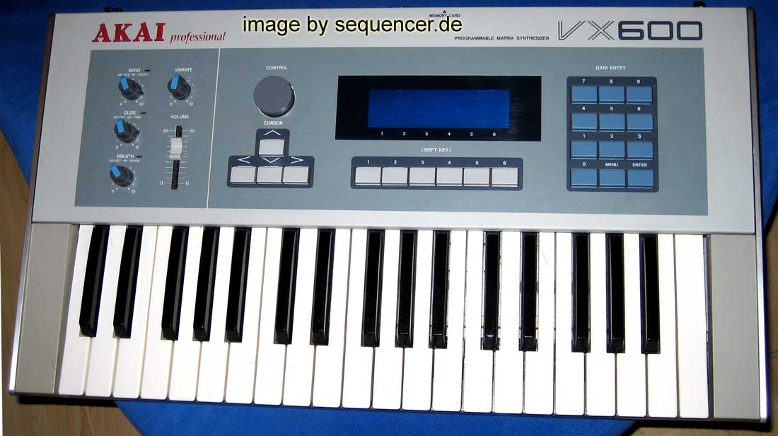

the AKAI VX600 synthesizer
akai vx600 synthesizer
pic thanks to plasmatron
is also analogue and has a mod matrix, FM and: a high pass filter
its advantage: the envelopes are faster than any of the others but it is a bit thinner ,cleaner and it’S filters do not sound as warm and nice as the oberheims and marions do.
the matrix does not offer the ENV parameters to be modulated, but some of the most important parameters CAN be moded of course!! VX600 also has VCO mod by VCO2 (FM) or VCF mod by VCO (filter fm), the VCOs are the same as the xpander, but to my ears it sounds different…
it is a small synth looking a bit like a nord modular in white with a small 37 note keyboard (3 oktaves)
of course you should not expect controllers or something ,but thats the same with the oberheim/marion stuff.
more about: Akai vx600 and other AX and VX akai synthesizers..
the Akai vx600 is a modmatrix synthesizer quite comparable to the oberheim matrix 6 / 1000 and marion synthesizer series.. in a very tempting 3oct-keyboard version..
more details: Akai Synthesizer section.
