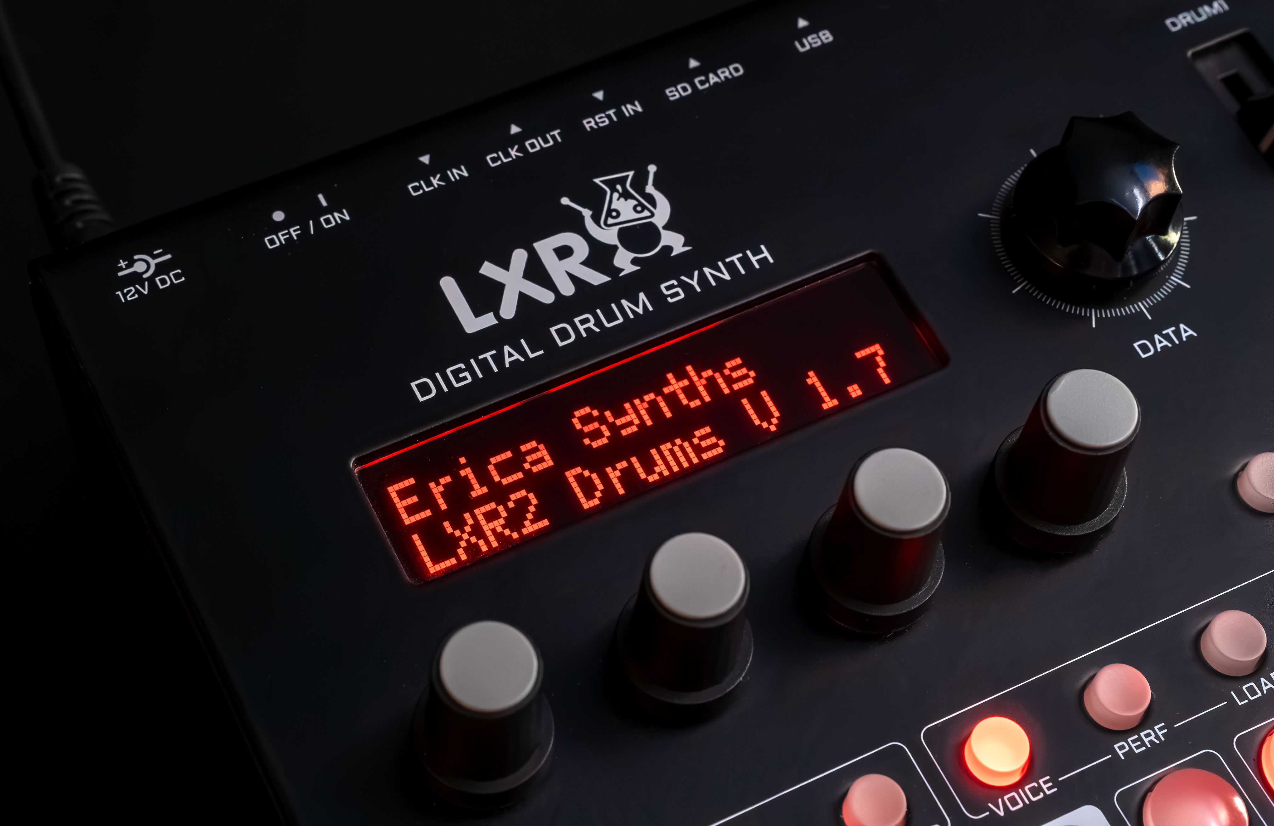

UPDATE 1.7 👍
We have taken over the firmware development from Sonic Potions and after many hours of painstaking effort we are delivering a much needed maintenance update!
LXR-02 V1.7 CHANGELOG:
* Compatibility with Octatrack when sequenced with MIDI
* Per-setp parameters displayed now when step is held down and can be changed. Max 2 unique parameters can be saved - if more are changed the oldest per-step param is overwritten
* Kit morph - when changing the kit, the morph-kit is kept the same. However, is morph set to 255, the morph-kit still slightly changes when swapping to a different kit, but way more manageable
* Delay when routed to an R channel does not crackle anymore
* Fixed MIDI clock going out of sync over time
* Fixed LXR starting sequencer randomly when synced via MIDI
* Added selection between MIDI (MID) or analog clock (EXT) in BPM parameter. MIDI and analog clock no longer work simultaneously
* When BPM selected as MID or EXT, encoder needs to be rotated more for changes to happen. This is to avoid accidental inputs when playing
