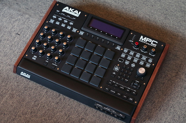

MPC Renaissance Black:
http://ghostinmpc.com/blog/2015/11/10/mpc-renaissance-black/
