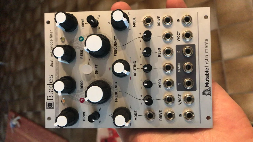

Feature-Übersicht:
An essential overdrive circuit
  • A CV-controlled overdrive stage precedes each of the two filters.
  • Overdrive response continuously adjustable between soft-clipping and 2-stage wavefolding.
Two rich multimode filters
  • Clean 2-pole (12dB/octave) state-variable design.
  • CV-controlled filter response, continuously variable between low-pass, band-pass and high-pass.
  • CV inputs with attenuverters for cutoff and resonance.
  • Unattenuated frequency CV input, calibrated for 1V/Oct tracking.
  • Clean self-oscillation across the audio range, extending into very low frequencies, with constant amplitude.
  • Modulating the filter response is akin to modulating the phase of the self-oscillation tone.
Unique routing possibilities
  • Continuously variable (and CV-controlled) routing from single to parallel to series.
  • With a signal patched into filter 2’s audio input, the routing knob and CV act as a crossfader.
  • Filter 2’s cutoff can be set relatively to filter 1’s cutoff.
Specifications
  • Fully analog, based on the V2164 quad VCA chip.
  • Frequency knob range: 8Hz to 18kHz.
  • Audio input impedance: 30k.
  • DC-coupled audio inputs.
  • Filter mode CV input impedance: 50k.
  • Other CV inputs impedance: 100k.
  • All CV inputs handle audio-rate modulations.
  • There is no mention of stereo on this page, ykinmkbykiok.
Ein paar Q&As aus dem Thread im MI Forum:
I guess it’s all analog at this point?
Yes, Blades is all analog! So all the tweaking is done by swapping component values, not by editing code :cool:
On what is the filter and the distortion based?
Shruthi dual SVF, and Zener diodes.
How much gain can the Drive provide - is it enough to patch in a line level signal as with Ripples v2?
It goes up to 20dB, which should be enough for bringing a line level signal to modular level. Two caveats:
  • It won’t distort / drive obviously. DRIVE will be cranked to the maximum but your signal will stay in the safe zone where everything is linear. You can solve that by “cheating” and adding a constant CV to the DRIVE input!
  • It’s slightly more noisy than Ripples, because the circuit is voltage-controlled!
