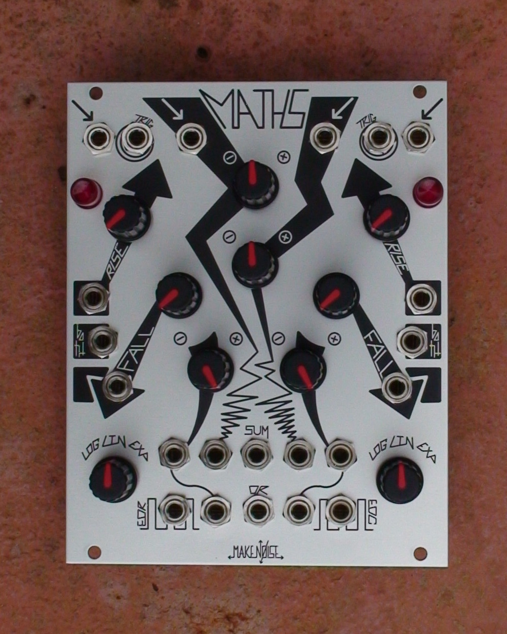

Buchla's "Algebraic Processor, Model 257" changed the way music synthesizers utilized control voltages.
MATHS, a mash-up of the Buchla 281, Buchla 257 & Serge DUSG, continues this great tradition of sculpting the control signals we use to sculpt our sound signals.
Channels 1 and 4 are identical, each being able to scale, invert or integrate an incoming signal. With no signal applied, these channels may be made to generate a variety of linear, logarithmic, or exponential functions, lasting as long as 25 minutes, upon the reception of a trigger, or continuously when the CYCLE switch is engaged. The Cycle switch also contains a LED which indicates the activity on the associated channel. One small difference between CH. 1 and 4 is in their respective Pulse outputs; CH.1 having End of Rise and CH. 4 having End of Cycle. This was done to facilitate the creation of complex functions.
Channels 2 and 3 are identical, each being able to scale, amplify and invert an incoming signal. With no external signal applied, these channels will generate DC offsets.
All 4 channels are normalized to a SUM and OR bus via their respective OUTputs, so that addition, subtraction and analog logic OR manipulations may be achieved. All outputs are capable of driving a passive 4 way mult without loading effects (no buffered mult needed here).
Das Modul ist sicher: SUPER!
Habe allerdings einen Augenblick gebraucht habe, um den "verborgenen" Quad Function Generator von Buchla zu erkennen: Die Frontpanel-Gestaltung ist eine Zumutung.
Ich fand das Frontpanel des Wogglebugs schon schlimm, aber das wird hier noch getoppt!
geiles Modul - gute Alternative zum nicht mehr gebauten Bananalogue Serge VCS
ich finds Frontpanel auch furchtbar
geiles Modul, ging jetzt zwar eine Weile und habe mir noch die Originale ansehen um das so ungefähr zu begreifen...
zum Design, das QMMG sah für mich am Anfang auch komisch aus und jetzt finde ich es gelungen
Der Z8000 von Tiptop ist imho noch cooler. von links nach rechts, oben unten und rauf runter. Hat was.
aber ich finde die bedienug der steps cool .
beim z 8000 kann man die steps nicht muten so wie es auf den ersten blick aussieht. aber er kann andere sachen.
jetzt fehlt nur noch das pressure points... :roll:
denkt dran: vorm patchen haende waschen nicht vergessen! :mrgreen:
Soo, ich hab jetzt auch ein Maths. Die Frontplatte sieht in echt irgendwie besser aus als auf den Fotos und mit der Beschriftung komme ich gut klar. Das Modul ist einfach geil. Bekommt von mir den Best Bang 4 Da Buck Award im Eurorack Land. Ich glaub ich brauch noch nen Zweiten. :mrgreen:
ich hab seit gestern eins &bin auch sehr begeistert. extrem flexibeles teil. koennte noch ein zweites gebrauchen :roll:
