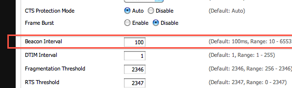

ahhhh, na bitte... damit kann ich doch schonmal was anfangen:
klingt als sendet dein router nicht oft genug ein beacon signal und der airport geht dann off weil er denkt das netz ist nicht mehr da. -> router firmware
Frequent wireless disconnects
Symptom: Wireless connection drops frequently; Airport icon in menu bar turns gray, eventually reconnects; poor throughput on large transfers
Cause: Power-save mode issue with some models, when beacon interval is long (1000ms down to some threshold)
Cure: Set access point's beacon interval to 100ms, if it is configurable
Discussion:
I believe the Mac Mini's internal Airport hardware is slipping into a low power mode due to certain management traffic from the access point. Specifically, a periodic signal called "Beacon" sends an "I am here" signal at intervals of between 1msec to 1000msec, depending on configuration. Beacons allow wireless devices to go into a power-save mode when there is no traffic to or from the access point, but it also seems to be the root of problems with the frequent-disconnect issue, at least on the Mac Mini here.
When beacons are frequent, they clutter the wireless channel with unnecessary traffic, and prevent power-saving devices from dropping into lower-power mode. So there is some motivation to impose a long interval between beacons. I had set my access point's beacon interval to the max 1000ms. Though the MacBook and other computers did not seem to have a problem with this, the Mini's connection constantly faded in and out, with the Airport icon turning gray, then coming back seconds later.
I think some less-frequent disconnection problems with a Windows laptop may have been related to this issue. With the beacon interval set to 75ms or 100ms, the Mini has maintained a constant connection to the access point. So, the problem seems to be in the Mac Mini's handling of wifi power-save mode. This is not configurable on the client, so the fix requires an access point on which this value can be set manually. The Airport Express does not have a configurable setting for Beacon interval, but this may not be a problem: we did not experience this issue when using the Express with the Mini.
bei mir sieht das am router so aus:

das ist btw. recht gut von den einstellungen her...
Beacon = 100ms
RTS = 2347 (effectively meaning "no RTS")
Fragmentation = 1024
DTIM = 1
preamble = SHORT
Security method = WPA2 and WPA
Encryption = AES Only
Key rotation = 180 seconds
