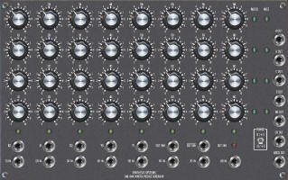

Supermoe setzt sich aus mehreren Modulen zusammen; ich besitze von Moe 2 x DAB1084, Frontpanel Daten zu DAB-1000 und DAB-1016 habe ich selber erstellt.
Kommentare von Moe bzw. von mir zu den einzelnen Modulen und den möglichen Bauteilen im entsprechenden Modul.
Generelle Info zum Design:
Super Moe design splits up parts of the sequencer that are normally in the same box. The inspiration was the modular sequencer from E-Mu back in the 70s.
Normally you have a counter in a sequencer that takes a clock pulse input and counts up. The outputs of the counter are a binary number. So an 8 position sequencer uses a 3 bit counter (2 raised to the 3rd power is 8 ). Another component is called a 3 to 8 multiplexer, which takes as input a 3 bit number (from the counter) and connects one of 8 outputs to an input. This is how they select a row of pots to turn on.
In my system (and the E-MU), the counter is separated into a different module than the multiplexer. The panels you bought are for a multiplexer which controls 4 rows of 8 pots. So the 3 counter inputs that make up the binary number are X0, X1, and X2.
The advantage of this is expandability. You can mult together X0, X1, and X2 from more than one multiplexer, then let them all shift together, and switch them on sequentially to extend your number of steps."

DAB-1084 Control Voltage Generator
Schematics hier: Teil 1, Teil 2 und Teil 3
