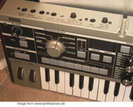

Korg MS2000B + KORG microkorg (VA) same as ms2000, but with 8step arp’er
difference microkorg <-> ms2000 <-> ms2000b:

microkorg vs. MS2000 / B the difference..
the ms2000(b) and microkorg share the same sound engine! so they are absolutely identical. the difference is: the microkorg has a „TR-like“ ARPeggiator: means – you can set anything you migh imagine in an ARP’er including to set one of 8 steps (it’s not a sequencer! but a hi-end arp’er).
the MS2000/b has a 16 step control sequencer, that can also change other than just „note“-data.. it is also able to run backwards!.. means: the ms2000’s sequencers is a very live-able built in control and note sequencer..
![]() better and larger? klick on the image  |

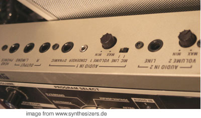

(microkorg back.. 2 audio ins!!)![]()  |
